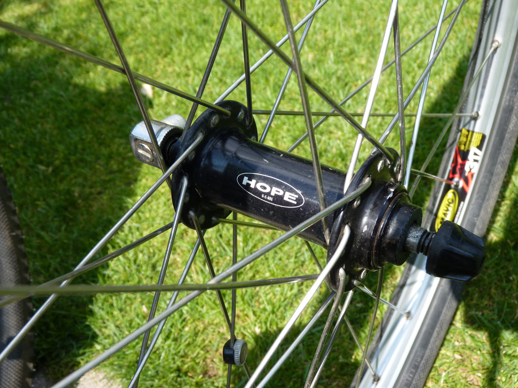

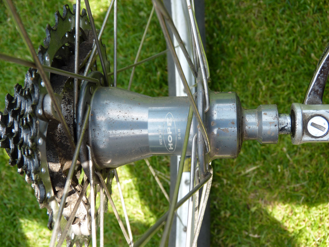

I bought these wheels quite a few years ago, probably from Merlin if memory serves me right, but what I'm failing to remember is what are the hubs?
I think they're older XCs as they're obviously non-disc, but the time has come for new bearings, especially in the rear. So it'd help no end to know what they are for sure, in order to get the right bearings and right set of new springs & pawls

Hope XCs have disc mounts. Pretty sure those are Hope Monos.
EDIT: It looks like Hope have since made a more recent version of the Mono hubs. I can't actually find out much about the old ones. Maybe give Hope a ring?

I think superficial is correct; however the flip side is that XC / Mono of that era are identical except for the disc mount IIRC
rear hub diagram - specifically mentions the axle as XC/Mono

Aha, thanks @stevehine that looks pretty handy. Interesting that the parts list at the top appears to mention 3no 6001 bearings, but the diagram shows 4 of them. I guess the answer is to procure 4, and that way I'll have enough either way.

Yup the monos are the same as the xc, bearings are same selection. Its the axles that is the important bit and these hubs only use the one type of axle, which the rear shares with the ti glide and the front shares with the sport and suspension.
I dont know what the service cost at Hope is, but to do it right yourself you'd need Hope bearings which are the best type, plus the setting drifts, plus I suppose the time and hope you've done it right and not made the bearing clicky. So overall costing the correct bits might only be slightly more expensive than having Hope do it correctly

If you end up replacing the pawls,make sure you get the correct type as there was a change in design around that time. If the freehub has closed pockets for the pawls, they'll be the later, smaller ones, if they're open then they'll be the larger types (don't be tempted to fit the smaller type, it'll end in damage).
