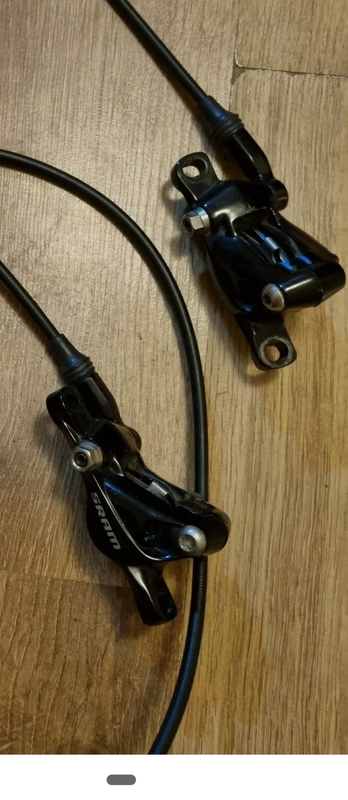

As above. I need flat mount but can get these at a good price..

Post on adapters
These are flat

So they are post mount? And i need flat mount adaptors?

They are definitely post mount. You'll need one of these https://www.chainreactioncycles.com/shimano-rear-post-to-is-disc-brake-mount-adaptor/rp-prod13749 to fit it to an IS (flat) fitting.

They are post and won't fit on a flat mount frame.
You’ll need one of these https://www.chainreactioncycles.com/shimano-rear-post-to-is-disc-brake-mount-adaptor/rp-prod13749 to fit it to an IS (flat) fitting.
That doesn't look right to me, flat mount has two holes vertically through the chain stay, similar to post, just a different spacing. That adaptor swaps the orientation of the fixing bolts?

IS mount is NOT flat mount, that adaptor is for the really old school IS mount which is rarely ever seen now on new bikes.
This will allow fitting of PM caliper on a flat mount frame.
https://www.chainreactioncycles.com/clarks-anodised-flat-to-post-mount-adaptor/rp-prod179773

Ah, sorry, cross-purposes there! Now I see what you mean! Those are the very adapters.
