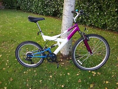

Are mullet set ups still popular? Wondering if this would be a good option...
Mullet
Posted : 21/12/2022 1:59 am
Posts: 2812
Wow, that isnt just a 20" wheel in a 26" rear end, but a proper (!) 20" rear end attached to a 26" front triangle!
