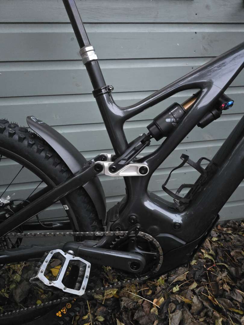

I bought one for the Levo after reading how much it transforms the ride...
Mine is the standard link though. Most people going to coil go for the LT link.
Levo is standard 160f/150r. The cascade link gives it 160r
The LT link with a longer stroke shock takes the rear to 170. So then it would be a case of upping the front to 170/180.
My Kenevo is 180/180, so I'm not too fussed about making the Levo a rock muncher (maybe in a year or two I will).
As for the difference - first ride I put some more air in the shock as I read this was required. Seemed to sit a bit down at the back, so went up a bit more and did feel nice and really supportive without introducing any harshness with the extra pressure. Has it made a difference - I'm not sure yet, but will see. Hopefully the X2 shock doesn't shit itself with the extra pressure.
