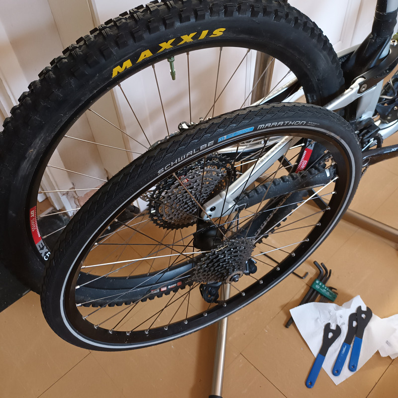

Re-aligned my hanger last weekend- definitely going to put an alignment tool on my Christmas list, bit of a faff using a spare wheel TBH. I think the B screw adjustment is quite particular with the 12 speed stuff too.
