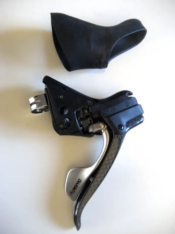

My mate has had the same issue with his on hos Cross bike, it's just turd. It's (the groupset) now being replaced under warranty with a higher spec one, he's already had 2 complete bikes to try and resolve it.
FWIW my Force CX1, 42 or 38t front with 11-36t rear has been ace, it's done 2000km of mixed riding including a winter of commuting and a whole 'cross season (10 regional, full national trophy series and national champs) under another rider and the shifting has just got a bit dodgy, fine going up, slow down so it's a simple case of a shifter clean & re-grease and a new gear cable.
I've heard (from a rather respected mechanic) the steel internals in the Apex shifter corrode, but the higher spec shifters are far better due to fancier materials - added to the fact that the shift mechanisim is essentially exposed as the cover on teh lever doesn't fully cover it, leaving the bottom of the ratchet exposed to dirt ingress - a major issue on a CX race bike.
