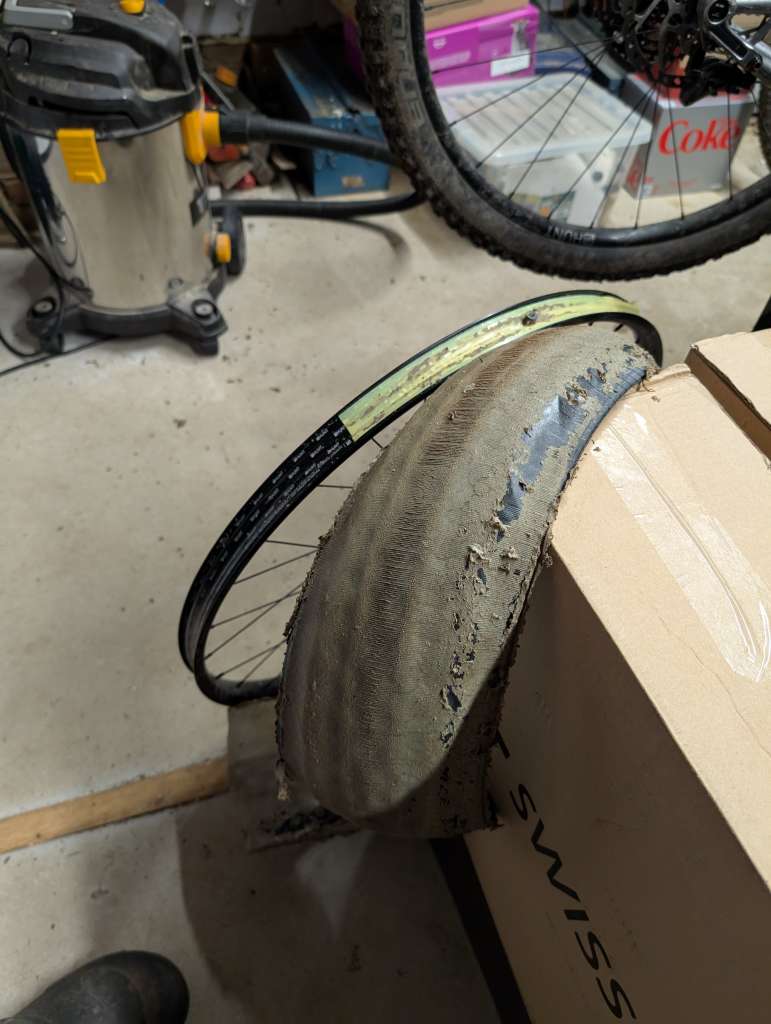

The horrible, slimy thing below is the dried on sealant from 2022. I've not had the tyre off since then. It stinks too! I'll get it all cleaned up and add some fresh Stans - and try to remember to do this at least once a year, the tyre was firmly glued to the rim with old sealant.
