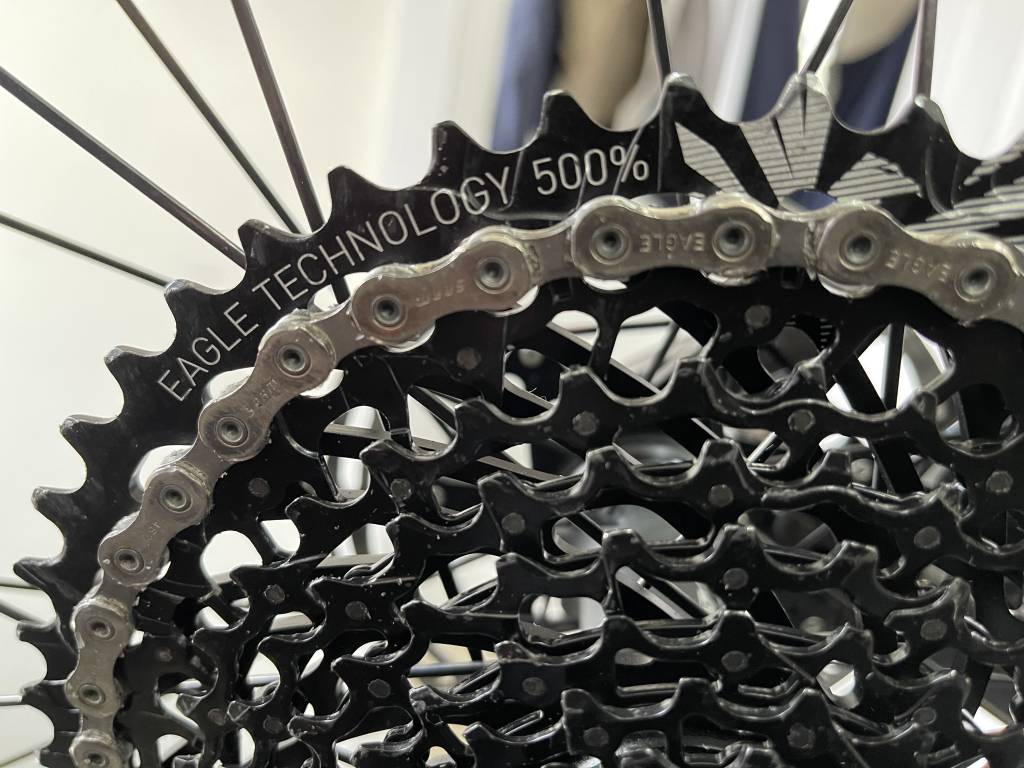

He's right you know - the chap in that video...
I've just fitted two GX cassettes to 2 different wheelsets and they both do it on the second from bottom gear. Not all the time and if I slacken the chain off and move it along one link it sits in nicely. Initially I did this chain movement and then couldn't get it to do it again so I thought I would just need to spin up and down the gears after taking the wheel off each time but the second wheel did it again even after I had moved the chain along one link.
I haven't ridden it yet this is only in the stand so maybe under a bit if load it will be OK...
The only common denominator here at the moment is the chain which is virtually new, 20 miles or so.
Posted : 09/08/2023 2:46 pm
Posts: 3296
Update - as above it also does it in the 50t cog. Been round the block and shifted up and down a few times but no instances of it  doing that. I’m off on a 140k road ride tomorrow so we’ll see. It will be mightily disappointing if it does do that awful mismatch while riding esp as I’ve just bought cassettes and XD drivers for two wheels 🙄.
Posted : 09/08/2023 5:13 pm
Posts: 3296
I dare say they all do it but perhaps none of you have noticed maybe?  I can only find one other post about it, on a Reddit forum, but it has no replies. Same issue though as the user posts a pic just like mine. Is it a SRAM QC issue? Odd that it’s on both cassettes that I have just bought.

Posts: 5055
That picture you just posted doesn't look like a new cassette - or have I missed something?
Posted : 10/08/2023 9:50 am
Posts: 3296
It’s a brand new cassette literally just out of the box. It’s been spun on the bike stand only and not ridden at that point. Probably just the wax flakes from my chain making it look old.
Posted : 10/08/2023 1:55 pm

Posts: 3296
He’s not, it’s nothing to do with “narrow wide” it’s a pitch/wear issue. (Or a mech/hanger issue)
it can’t be hanger/mech as it was perfect on the NX cassette and it’s not perfect now. Bike hasn’t been anywhere in between. Also, if I move the chain along 1 link when it’s sitting correctly without turning the cranks or anything, it sits incorrectly as per the pic. The problem with that is that it does it occasionally while shifting into those larger cogs. There is a review on Bike Radar that has a quote from a SRAM guy which says the reason they had to go 52 teeth on the larger one rather than 51 like Shimano was because of the narrow wide on the top two cogs.. so my guess is that the ramps aren’t catching in the right place for some reason. Definitely the top two have indents in the teeth every so often that push a bit out the other side which makes them wider for sure looking at it.
That said I went on a 60 mile ride with it today and although it was a fairly flat route so I didn’t go into 1 or 2 more than a few times, I didn’t notice an issue so maybe when it’s under a bit of load it’s better…
Posted : 10/08/2023 4:23 pm

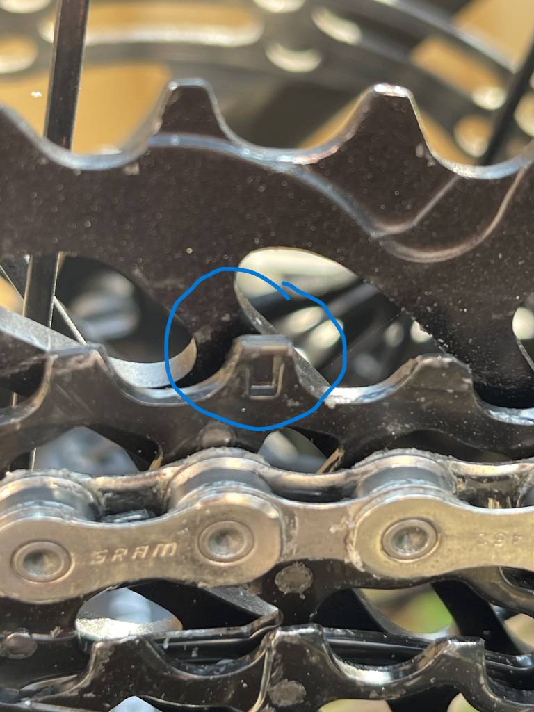

 mert
Posts: 3831
Shift gates. To get the chain up. And allow it to drop.
There are some (fairly) simple rules for aligning shift release and shift pick up gates between sprockets, it's why shimano sprockets (and double/triple chainrings) have letter codes and compatibility charts, to make sure the gates/pins on each sprocket/ring line up properly. If anything, that will be one reason why they've gone from 51 (one set of gates every 17 teeth) to 52 (one set every 13 teeth). Might be that SRAM shift gates are just shit.
You can't have narrow wide on any sprocket or ring with an odd number of teeth, or with an odd number of teeth on any sprocket in the cluster. Or you'll lose the synchronisation as soon as you use the odd sprocket, or skip the chain during a shift.
Posted : 10/08/2023 5:10 pm

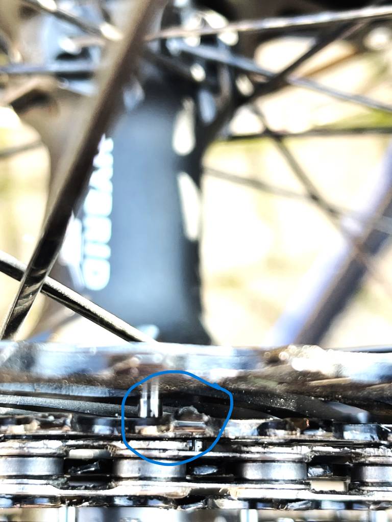

Posts: 3296
These are the indents I am talking about
And the same tooth from above - hard to see but it's definitely wider than the adjacent teeth.
Posted : 10/08/2023 7:02 pm

Posts: 10485
Bottom (easiest) two gears. It’s pretty common to wear them out first on a 1x system of you ride hills and like to just spin.
Or your chainring is too big for where you actually ride 😉
I got the noise in 5th from smallest, turns out its not uncommon for 10-50 GX eagle cassettes to have a slight bur on one of the teeth, a dab with a Dremel and all is good,
Posted : 10/08/2023 10:19 pm
Posts: 5055
Oceanskipper - the last two pics, that's the new cassette?
Really doesn't look like any new cassette I've ever had.
Posted : 11/08/2023 8:32 am
Posts: 3296
I can assure you it was brand new out of the box, I bought 2 from the people Tracey linked to further up. They were in sealed SRAM boxes and pristine, literally on Wed. I hadn’t even ridden it at the point the first pics were taken, just spun it in the stand and shifted up and down a few times. It has wax on it from my freshly waxed chain which makes it look like that in the pics I suspect, as the wax flakes off a bit from a newly waxed chain.
Posted : 11/08/2023 8:46 am
Posts: 3296
So, bit of an update, long story short I spoke to a Specialized dealer about something else and happened to mention it. Apparently it’s normal behaviour when the bike is in the stand with no load on it. I did wonder that myself and seemingly it is the case. 🤷‍♂️
Anyway hopefully not an issue while riding.
Posted : 11/08/2023 1:28 pm
