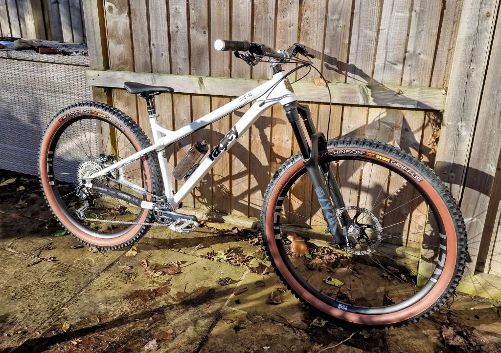

Run them on my Big Al
1) Don't make the mistake I did and ignore the reviews and stick a 2.5 on the back. It's draggy. Now got 2.4 on the back (2.5 front) and it's much better
2) They seem to roll really well on hard pack
3) General grip seems good
4) Reviews say they are ok in all but the worst slop. But I've found even a bit of a slippy muddy surface results in terrible forward traction under pedalling. Looking at the shape of the knobs you can see why
5) Cushioning seems decent. There's something really comfy about my Big Al (alu HT) and some of it has to be down to the tyres. Running tubes 20f/18r
6) They look fab (if dark tan walls are your thing)
Bit of a mixed bag really. Would I buy them again? As a three season tyre, maybe. As a winter tyre, no.
20231111_113435~2
