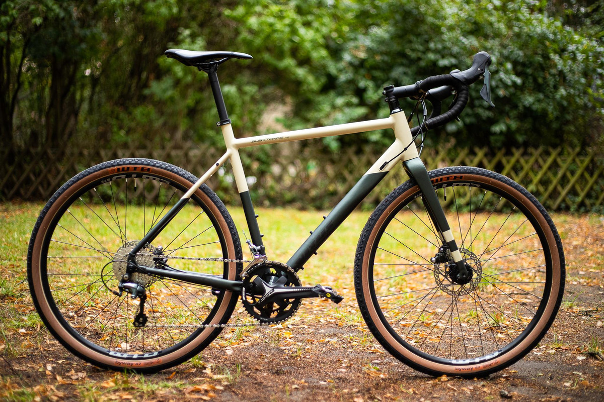

This came up on my Facebook feed:
https://www.evanscycles.com/pinnacle-pyrolite-1-2019-adventure-road-bike-EV306269
I'm wondering what it would be like riding big fat tyres like these on road? Obvs not quite as fast as a full on roadie but I feel like it would probably worth it in my local terrain.
If you have a bike like this how do you feel about it?

I have a 650x47 wheel/tyre set for my VN Amazon. Definitely slower going than thinner rubber but it gives me a great option for heading off onto rougher tracks. Very pleased with it.

I'm running the same 650x47 WTB tyres on my Bokeh with no issues at all.
I use it as pretty much my go to bike so it goes out on club rides and I never really have any issues keeping up with everyone. For my commutes it's nice and comfortable but again not obviously slow comapred to other bikes I've used.
My other bike is a singlespeed gravel bike, a Trek Crockett, which is running on 42mm gravel king tyres and again it doesn't feel slow at all and keeps up with mates when I'm out riding with them.

a mate just bought one of these, for under 500.
https://www.chainreactioncycles.com/marin-pine-mountain-27-5-hardtail-bike-2019/rp-prod186798
Not 'gravel', but a monster

I've got a Whyte Glencoe - bought it 2nd hand and it's ace. Yes slower on road but great for commuting and comfy on the 'roads' in Somerset.

I have G Ones in 650b x 50. Yes, not as fast as 23s etc but different type of bike too. I will happily ride all day and across a variety of surfaces.
I had Byways in 650b x 47 before that on my previous (now stolen) bike and liked them also.
I guess it depends how/where you ride but they sure work for me.

I have 2 gravel bikes, one more road oriented, a Croix De Fer, with carbon fork and 35c tyres, and a Vagabond, with 29x2.1 semi knobblies.
The CDF sees winter road duties and light road and off road touring and is only marginally slower than my carbon Defy on 25 rubber.
The Vagabond is a more relaxed affair, and noticeably slower on tarmac, but as soon as the road runs out it becomes amazing fun and as fast as the CDF on most gravel paths I ride regularly at nearby windfarm.

I've got a set of G-One 650x50 tyres on a 22lb all-road bike at the moment and for solo rides on rougher roads and lanes the bike isn't really slower than my 17lb road bike (23 or 25mms). The road bike picks up speed and climbs a bit easier and would be more reactive in a group ride but it loses out on efficiency whenever the road surfaces are bad (ie most of the lanes around here) and at times I have to slow down to be safe where the 650 bike can stay at speed. All in all I've been suprised how little difference there is in average speed for 3-6hr rides and longer on those roads - maybe 0.5 to 1km/h. On some hillier routes on bad roads the 650 bike is quicker. On smooth roads when I'm feeling good there can be 2-4km/h in it in favour of the road bike.
There's a 6-7hr ride I do fairly regularly, have done over a number of years on many bikes in a wide range of conditions. Bad science I know but my 2 fastest times along it going each way were on a light Alu road bike on 650 x 42mm tyres (Pacenti Pari-Motos, a light Panaracer casing), faster than my Equilibrium or my 'best' road bike. That was the V1 Pyrolite (2014). The Horizons aren't quite as quick (they feel better the more worn down they get ie thinner rubber layer on the central tread area) but in general the bike works the same way - keeps the average speed and efficiency high on UK roads over mid to longer distances. I think there's a lot of sense in the BQ take on tyres. Some of all this might be how the bikes work for/with me, I'd not make a good crit racer at all but I can hold a reasonable pace for a longer distance.

Wtb byways are bloody brilliant.
You're not going to see much, if any difference riding on the road, as confirmed by gcn:
And the advantages on the road outweigh any tiny loss in speed: more grip, no worry about potholes or rough roads, much better comfort.
They're very capable off road too, maybe not in the wet but in the dry you can find yourself going very fast on loose gravel and dirt 😁
I don't do 'proper' road riding on mine but I do commute occasionally, ride gravel, light off road etc. I'm quite happy doing 40-50+ mile gravel rides, comfort not an issue.

i've got 2.1 thunder hurts on mine. definitely slower than thinner 700c wheels and tyres but a whole lot more fun.

I'm running 700c wheels with 45c WTB Riddlers. Pretty wide tyre and fits in my Arkose fine without the need to go 650b.

^ that's the cross-over size I think - 700x45 has such similar pros and cons as 650x50. A Horizon 47 or G-One 50 has a fair bit more volume than a Riddler 45 but (apart from when you hit a root hard) they feel so close in all-round ability to me. Balance point of volume vs OD/roll-over advantage maybe.

Posts: 278
Yeah...
47mm Vittoria Terreno, road mode.
47mm Senderos, winter mode.
50mm RaceKings, summer mode.
It's excellent setup, and I rarely use my hardtail now. (but I do live in a very flat part of the country)
I swapped my 700c wheels for a mates set of 650b and use 47mm for road now, although my tarmac miles are very few.
Posted : 12/10/2019 9:38 pm

I Do like The WTB Horizons 650 x 47c but tbh for my winter road commute I’m playing with gp5000’s in 32c.
If your playing on gravel and road the horizons are great but I found them soul destroying on just road for the commute whereas the gp500s on road are really good.
The horizons are surprisingly fast thou for the size and you will be surprised and they very comfy and sure footed on rough potholed roads.
On a mixed off road/road Commute they’re fab.

That Stayer is a lovely bike. A lot of thought in the details. Hope you are coping ok around London on 29 x 2.8 ok though.
Tried 650b x 47 Byways on a longish medeterranian Alpine multi day route with a fair bit of gravel, only benefit over 700c x 45 riddlers used for an equally longish (900km) Scottish gravel/singletrack bimble, was a slightly smaller diameter which made the climbs easier. I have stuck with 700c x 45s as I think it rolls a bit better on everything other than tight singletrack. Think 650b x 47c "road plus" was a compromise for smaller clearance frames. Have tried 2.1 (52) x 650b and that was quite different. More rowdy.

Yeah, It's a very orange Mason Bokeh in size 50cm.
For my very few and very un-competitive road miles the 47mm are fine. No-doubt that a set of 700x35 or less would be faster but I like the visuals of the big tyres and the way it shows i'm not taking stuff to seriously.
I was able to keep up with a mate on a full aero 23mm thing the other night for 40miles so they must be OK. He was tippy toeing around, wheres I was just smashing though stuff not giving a 5h1t.
