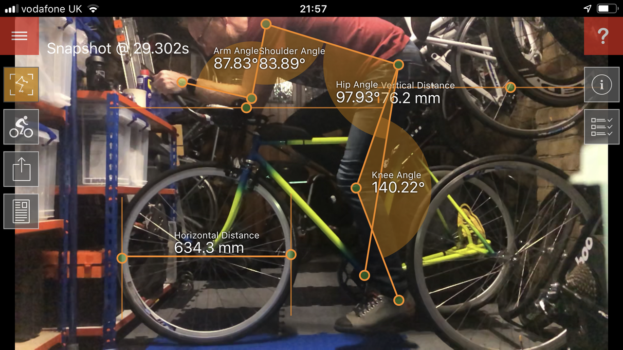

Is that app is on Apple only matey?
Yes I believe so. It is, however excellent. I run it on an iPad and now my iPhone.
Sample screen shot with knee bend. This is one frame from a video that you scroll through to reach bottom of stroke.
When doing it properly I use orange dot stickers on the lumps and bumps. This was just playing on the trike, but you get the idea.
