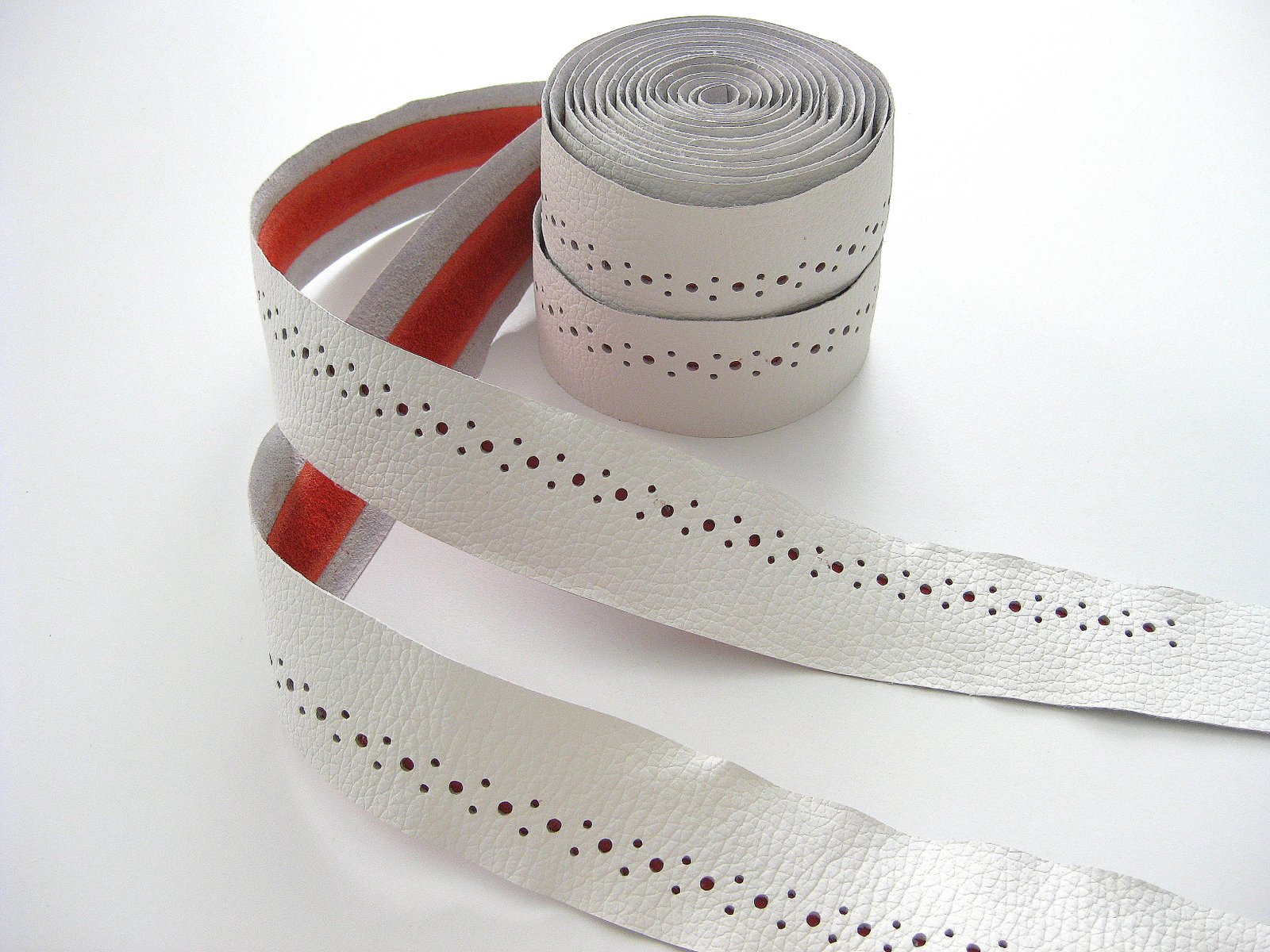

[i]I also own a tape machine, BTW[/i]
Please elaborate.
I recently discovered some very nice leather bar tapes made by a chap, the name for whom I could only deduce as "[i]busy man[/i]".
