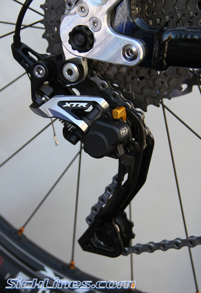

I like the look of this for helping keep the chain on my 3x10 setup. Well the marketing spiel has me hooked. Has anyone tried one does it make any difference?

They're brilliant - honestly, it really does make a big difference. Equivalent to a short cage mech and chain device i'd say, maybe more so - it almost eliminates chain bounce.

If you can get away with running a medium cage you could always try a Saint mech as the spring in that is much stiffer and should do a similar job to the XTR plus, at a much cheaper price.
