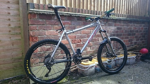

I'm on what became the on one hello Dave. Bought second hand for cash, not a pre order!
Kneepads used to keep my knees safe from the bars 🙄
short
less short
