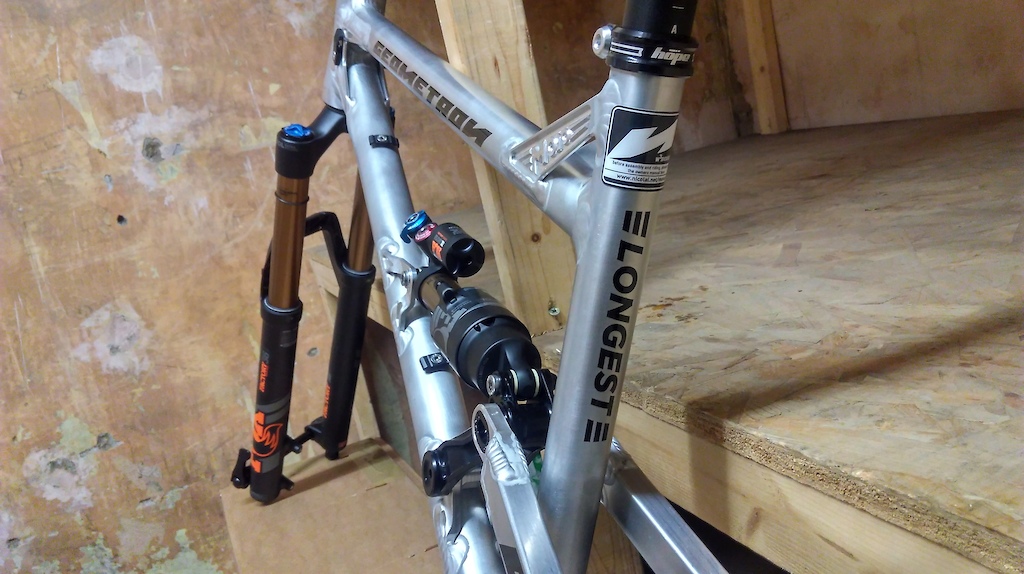

I've just ridden my first Geometron! Just briefly but enough to form some opinions.
It was a Longer, and the owner is good 5 inches shorter than me. The reach from the saddle to the bars felt and looked similar to my current bike (large Cotic Bfe, confirmed with tape measure) but in every other way it dwarves it. BB to top of headtube is 10cm longer.
I'm surprised by how normal it felt considering you can see the whole front of the fork from the saddle right down to the axle bolts. When the saddle is up it puts you in a very central position right above the cranks. On the Enduro 29 demo bike I've been riding, when you pop the saddle it feels like you're right over the back axle. It felt very nimble and easy to carve around on. I'm also pleasantly surprised by how light it felt (I didn't weigh it). It wasn't a weight weeny build but it certainly felt 'modern day trail bike' weight.
I'm 6'2" on a good day so not sure if I need a Longest. The Longer is way bigger than anything I've had before. Now that I've had a good poke around a bike I'm a lot more convinced that I want one. Nothing about it put me off.
Only one thing struck me as a complete ball ache just waiting to happen. The rear brake hose runs under the welded on shock mount. Which means every time you want to fit or remove a rear brake you have to remove a calliper or lever. On a Hope brake with a braided hose that will be nerve shredding stuff!

Sharkattack. I really would recommend trying out a Longest at your height. To save me going through the thread where are you?
As mentioned it's easy to set up a Longest to be the same cockpit and physical reach as a Longer but you would have the option if needed to increase the space. You can do the same adjustment with the chainstay using a different insert (+5mm)
And you change the travel by using a different shock. You get the same leverage as shown in the video.

Posts: 8842
Well, here we go....
So glad I went for raw instead of black. I love black bikes but this is so shiny in the flesh and it shows all the details.
I'm not one to gush about bikes but now that I've got it, I'm pretty excited about it. It's a beautiful bit of machinery and it's already got about 20 different sets of finger prints all over it. All those big, fat welds and machined bits had everyone touching, poking and rubbing it before I could get it stashed.
That's it for now. A big box of Hope goodies should land tomorrow and it'll be bike shaped tomorrow night. I might have to wait for pay day for bars, stem, saddle, drivetrain etc...
I've been riding a steel hardtail for 4 years I am literally gagging to smash through some rock gardens.
Posted : 20/09/2017 5:33 pm
