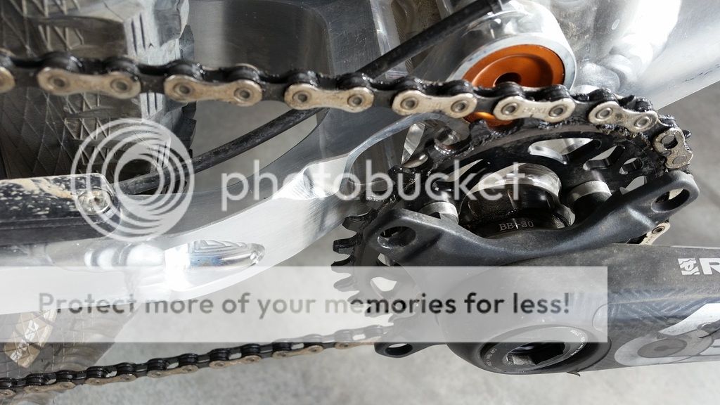

That chainring setup just doesn't look right.
agree - looks like he are using the wrong mounting point on the spider, he has the chainring mounted to where the granny ring would normally mount. A typical 32 tooth ring would normally mount to where the middle/outer ring goes.
It would if he ran a 73mm or boost crankset, but as stated in his earlier comments he is using a 83mm bb crankset and 4mm spacers.

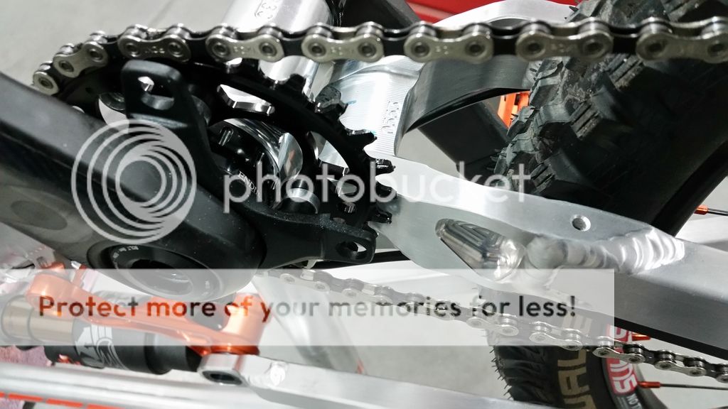

I am a Mechanical Design Engineer, and I approach this subject from an unbiased point of view, using logic and experience as my guide, not bicycle industry "norms", which are hard to pin down with the ever changing standards.
I chose to make my crank arms equidistant from the down tube because that is intuitively the correct thing to do ergonomically. Why should I vary from this if I don't have to? Moving the crank set to one side to improve chain line is a poor compromise at best.
In my opinion, the 148 boost cassette is dictating the proper location of the chain ring. I chose to make my chain ring align with the middle cassette cog because it is the ideal position to minimize chain angle and related issues like chain drop. With this chain line I suspect a chain guide will not be necessary.
It shifts superbly and thus far there have been no issues at all. And yes, it back pedals on the 42T without complaint or a hint of derailment. I will be keeping my chain line where I have it, as I see no reason to make it worse.
My chain ring measures at 47.4mm chain line. The center of a 148 boost cassette is 47mm, as seen here: [img] ?7100227419112134174[/img].
Some people recommend a chain line 49-50mm for various reasons, such as swing arm (chain stay) clearance and tire clearance. These issues don't concern me, so I will quite happily leave the chain ring where it is at the moment.
With the chain on the largest cog 42T, the 2.35 tire clearance is 9mm, while the industry minimum is recommended to be 6mm.
The chain ring is closer to the swing arm yoke (chain stay) than the industry would like, but I can easily clearance the yoke (remove a little material) to accommodate a larger chain ring or add more clearance.
Prior to ordering, during my analysis of the 2017 G16, I realized that there would be a significant discrepancy between the RaceFace specified 83BB chain line of 57mm, as seen here: [url= http://www.raceface.com/media/Crank_Q-factors_and_chainlines.pdf ]http://www.raceface.com/media/Crank_Q-factors_and_chainlines.pdf[/url]
and the 47mm chain line of the cassette. That is why I chose to use a spider instead of a direct mount chain ring, which has no adjustability. My chain line concerns were not enough to dissuade me from ordering this superb chassis because I assumed I could sort it out with the removable spider.
My middle ring position measures ~60mm due to not offsetting the crank. That is 13mm wider than what I consider to be ideal.

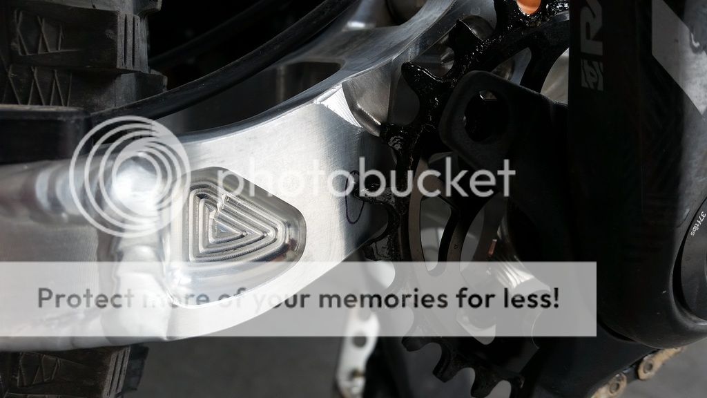

Without an FEA I would say......if you say so chief.
FEA is of limited value, depending on the software used and the constraints on the part.
Did you notice the rather large pocket in the side of the yoke? What I am talking about would be a mere scratch compared to that. In addition, there is notch that you cannot see in that picture.
Here you can see the notch in the yoke:
In this picture I have drawn an oval to represent the small area where I would remove material if necessary for clearance. It would be very minimal compared to the pocket and notch.
I would be happy to run an FEA before and after if I had the part available to me, but it would be completely unnecessary in my opinion.
For those who may not have noticed, this yoke is now a very nice single billet part. Previously it was a bolted together three piece design.
