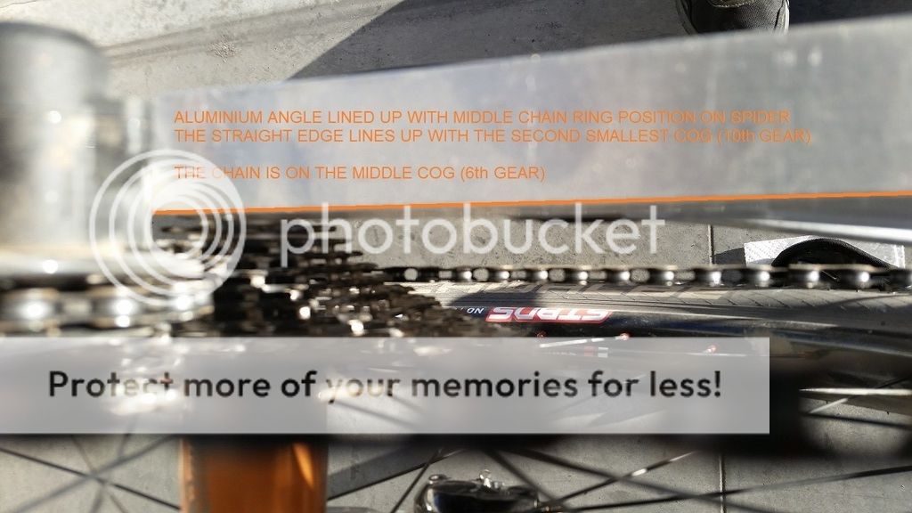

[img][url= https://c1.staticflickr.com/3/2454/32752616551_f2375eaa8d_o.pn g" target="_blank">https://c1.staticflickr.com/3/2454/32752616551_f2375eaa8d_o.pn g"/> [/img][/url][url= https://flic.kr/p/RUeHPn ]IMG_0698[/url] by [url= https://www.flickr.com/photos/the_pilot/ ]Phil[/url], on Flickr[/img]
Posted : 13/02/2017 10:02 am

Also has new 2017 rear end as Chainline,s picture.

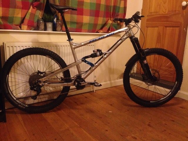

Current drawing for the Not-So-Long.couple of tweaks to do with features but pretty much good to go.
[img][url= https://c1.staticflickr.com/3/2746/32537040340_99dcc1fd02_b.jp g" target="_blank">https://c1.staticflickr.com/3/2746/32537040340_99dcc1fd02_b.jp g"/> [/img][/url][url= https://flic.kr/p/RzbQw9 ]Mojo G16 notsolong[/url] by [url= https://www.flickr.com/photos/the_pilot/ ]Phil[/url], on Flickr[/img]

Hi Guys,
I received my 2017 G16 Longest as expected on Friday February 3rd. It only took three days to get to Arizona. The shipping was rather expensive at 170 GBP (212 USD), but it did include comprehensive packaging (miles of tape and bubble wrap) and "overnight" shipping. Everything arrived in perfect condition.
The following shipping info is for potential US customers.
On Tuesday it flew from the UK to NY via TNT carrier. It was then put on hold for customs clearance. TNT required my Social Security Number for some reason. The customs fee was only $60, which I paid to TNT. The frame was quickly released by customs, and TNT transferred it to the next carrier. Unfortunately, TNT did not automatically provide a tracking number for FedEx, but I got this information from FedEx and I was able to stop the package from going out on the truck Friday morning. I did this so I would not have to sit around all day waiting for the FedEx truck. They might have left it at the front door, where anyone could come along and steal it. It was a simple matter of driving down to the local FedEx office and picking up the package after 9am.
Assembly:
The day I received it, I got a stainless wire brush and Scotch Brite pad and cleaned up the oxidation around the welds.
Next, I fitted the RWC BB cups which come with a coating of Loctite on the threads. The left side cup with right hand threads fit just fine, but the right side cup with left hand threads was super tight. It took more torque to thread it in than the recommended tightening torque of 40 Nm. I suppose either the threads on the BB shell or the threads on the cup were a little too tight.
Before ordering the frame, I had concerns about achieving the desired chain line, especially with a direct mount chain ring.
To give me the most flexibility, I used a RaceFace 83mm crankset with their removable spider. I'm glad I did. With this combination, the middle chain ring position lines up with the second smallest cog, which is far from ideal in my opinion. It seems intuitive to me that you would want the chain ring to line up with the middle of the cassette.
When I assembled the crank set, I used the spindle spacers to center the crank arms, so they are the same distance from the down tube.
Then, I used 4mm spacers on the inner chain ring position, which lined up the chain ring within 1mm of the middle rear cog on the cassette.
With this alignment, the chain ring just clears the yoke by about 1mm. If I want to bring the chain ring in any more, or use a bigger chain ring, I would have to machine some clearance into the side of the yoke.
The problem with the inner chain ring is the selection of sizes is very limited, with only 28T or 30T in oval rings. I have designed a simple adapter to go from the 64BCD of the inner position to 94BCD (SRAM), which will allow the use of Absolute Black oval chain rings in 30T-32T-34T.
In order to use the middle chain ring position, I would need a special adapter, 12-13mm wide, which I can make, but I will not do that unless there is no better option.
With the chain ring where I want it, there is no room to mount the chain guide. I will try riding without it, but if it becomes necessary, I can machine a few mm off of the mounts to make it work.
The rear brake post mount is for 180mm rotors. I am using a 203mm rotor, so I made a custom spacer to raise up the caliper.
My next post will include fitment results and riding impressions.
Cheers,
Scott
Posted : 21/02/2017 11:36 pm

Any Pics Scott? I thought the Bike was a specific 1X set up, did you get a mech hanger brazen on by Nicolai?

It's odd you are having such a hassle with chainline. On my longest I fitted XTR cranks with one spacer as standard, an 11 speed cassette and it works flawlessly, even back pedalling in the lowest gear does not drop the chain. I would not be too concerned with where the chain appears to be relative to the cranks and cassette and just go on how it feels.

I've been following this thread for a while now and have found it really helpful - even though I haven't contributed anything! So cheers guys...
Thought I'd share my G16 build with you - it might be sacrilege to you guys at Mojo as it's a Rockshox build, but I'm absolutely loving it and it enabled me to simply swap over my parts from a previous build. Currently running a 160mm Pike on the front and would ideally like a 170 (have tried to find a company that produces/would be willing to machine me a 10mm integrated crown race spacer to test the geometry benefits before I drop hundreds on a new fork), but so far to no avail - if anyone knows of anywhere, or has an alternative suggestion please let me know!
As has been said repeatedly, I haven't really found any negatives to the 'radical' geometry, she's a big beast and certainly no xc whippet, but for a bike with its intentions, I've never ridden anything that climbs as well. Point it downhill and it's simply outstanding; it can be set up to give a lively ride or ludicrously planted and stable - the chassis doesn't limit this in any way. As for cornering, I'm getting increasingly irritated with people telling me you need short chainstays to corner well - everyone needs to slap a Geometron into a tight corner at a good lean angle and think again.
[img] http://www.pinkbike.com/photo/14437619/ [/img]
[img] http://www.pinkbike.com/photo/14437617/ [/img]
Posted : 22/02/2017 9:42 am
Posts: 65968
scottarizona - Member
It's not actually so important- as long as it's reasonably near the middle it should work fine (the middle 3 rings are pretty equiavlent to the chainlines you get from a double chainset).
There's an argument for it being better to have the chainline off to the left, to bias it onto the lower gears.
Posted : 22/02/2017 9:57 am
Posts: 7913
Webbe's bike
Posted : 22/02/2017 10:47 am

^ good work the Podge!
Nice Bike Webbe!

Webbe, to sort out the angles you want to test just get yourself a cane creek angleset, throw in the -1.5 cup and you'll be golden, trust me 😉 The EC56 lower cup will give you about 11mm of lift at the front on your bike to give it a 170mm position, the -1.5 angle will deliver the 'correct' front end as per a 2016 bike which it looks like yours is from the head tube (can't see the integrated guide on the gusset)
Scot, keep riding, the more you use it the better it will get, the fun on 'average' trails comes from increasing confidence in the front end grip and pushing the speed, the flat/shallow gradient cornering is fantastic, I just love carving it like a snowboard in the turns.
I'm slightly puzzled by the chainline process, I'll chat with CP about it. No other feedback to that effect, but you should also find yourself in the higher gears more often with the anti squat properties.

Phil, can you elaborate on this please?
Posted : 23/02/2017 1:31 am
Scott,
Two parts to it, depending on the front ring you decide to use there is a kind of magic gear! It sounds odd but I can only describe it as the right balance of anti squat point relative to your cadence and setup, you may find yourself not always dropping to the absolute lowest gear at the back where you normally would. Myself and others have found that there is a particular gear (4th in my case with a 32 front) that just feels very efficient.
The second is you are likely (If my own experience and many I people I've dealt with holds) to find yourself carrying more speed in general and looking for higher gears, over here (As I don't know what suspension you have on it?) a combination of really good suspension setup in conjunction with the geometry and forgiveness of the bike when breaking traction generally results s in people travelling faster on average than they have previously and just carrying bigger gears, particularly downhill and on the flat.
I often find myself in the higher half of the gears, 11spd for a large part of my rides.
Posted : 23/02/2017 2:40 pm
Before the first ride.
Posted : 23/02/2017 6:51 pm
With the chain ring in this position, it is lining up very close to the middle cog on the cassette.
This shows a piece of aluminium angle lined up with the middle chain ring position on the spider and the second smallest cog (10th gear).
Posted : 23/02/2017 7:11 pm
