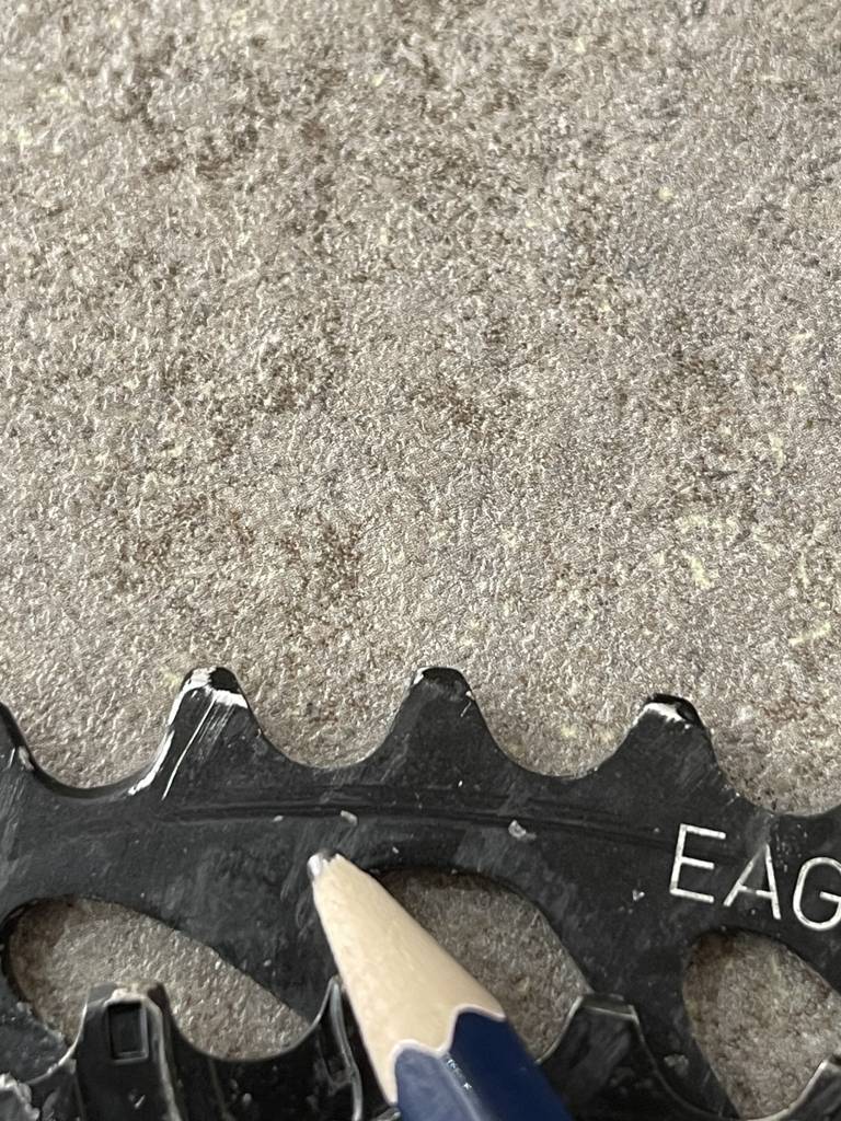

So, some further investigation... I put a pencil on the stay and moved it closer bit by bit to the cassette while it was spinning so it was rubbing on the wobbling bit as indicated below.
Pencil Mark
I then removed the cassette and placed it in a flat surface and pressed the edges as per the video below (you can see the pencil mark which is where I first start pressing):
https://youtube.com/shorts/eYCLN687Gpg
Now given that these are both brand new and exhibit the same issues I am thing it has to be a QC issue - unless, which is my question really, unless they all do this. I only have experience of 2. I have refitted my NX cassette on one wheelset and it's absolutely fine.

I took the cassettes into my LBS who confirmed they are wobbly and are sending off to SRAM for a warranty claim. Good stuff as I didn't buy them there (I did buy my new bike there though) - assuming they get replaced that is. Does leave me thinking SRAM QC is a bit meh though as this was two wobbly cassettes. In a fit of "what the hell" I bought an XO1 cassette to try and it is a billion times better than the GX cassette. It's straight for a start, but immediately I could tell that the shifting was silky smooth and very very quiet when running. I haven't ridden the XO1 yet as it's pissing down again but I am thinking currently that it is well worth the extra £££ particularly if you wax your drivetrain. Still, bloody expensive though - it had better last three times as long as the GX....
