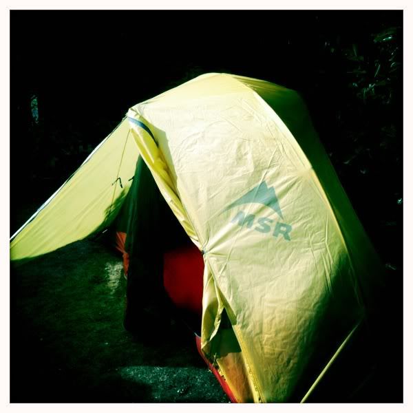

we've got a Hubba Hubba HP and when using it at the weekend without the footprint for the first time a lot of stuff on the groundsheet got damp, it seamed anywhere there was pressure on the fabric (sitting, kneeling, under mattress) it got damp, it was pitched on damp but not saturated ground. It's always been used with the footprint so is highly unlikely to have been damaged by abrasion.
I've emailed MSR but had no reply yet, has this been other peoples experience? The groundsheet supposedly has a hydrostatic head of 10,000mm.

Yeah, Ive got one.. Bought it off FLV from this very forum..
To be fair, Ive never had any dramas with it, and It's been used in some pretty crappy conditions on the Fells in the Lakes..
So, sorry, I can't be of any use..
Good luck getting squared away, they are great tents IMHO...
