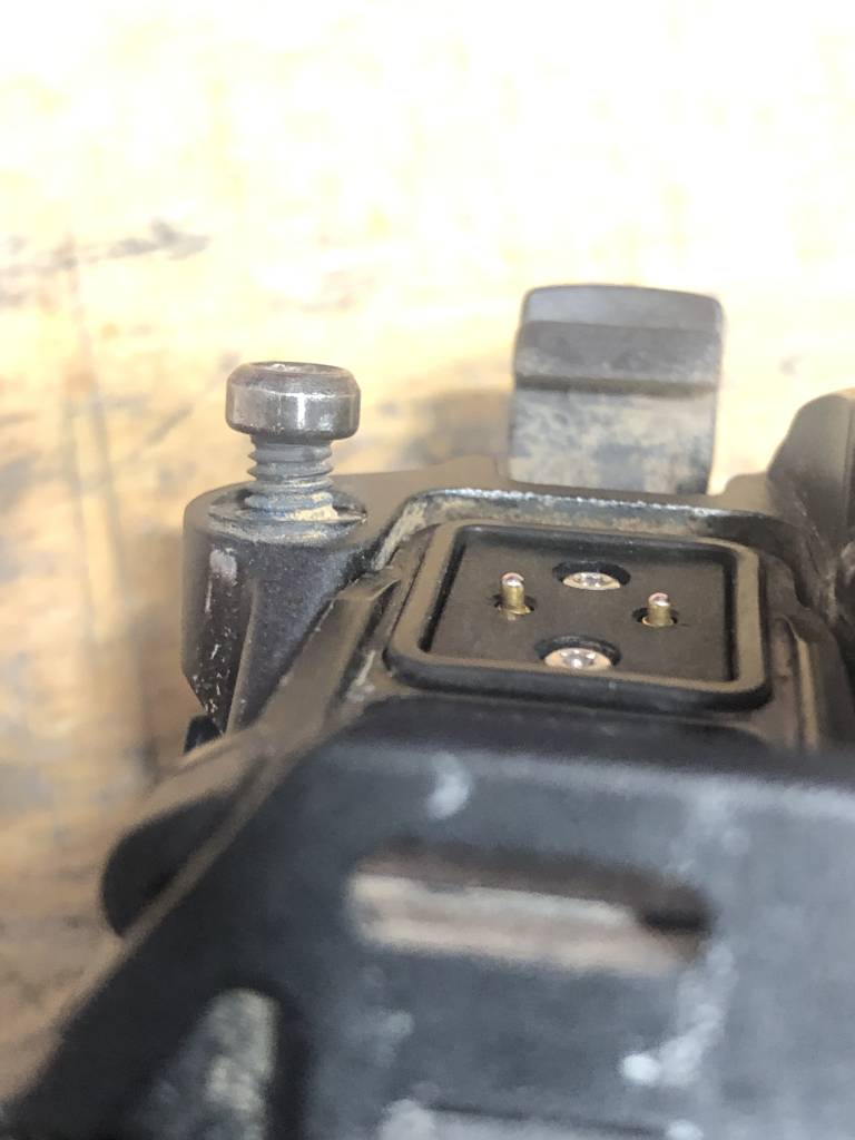

My out of warranty mech has starting playing silly buggers and will only operate if I hold the battery in place very tightly. Some googling has indicated that it may be caused by wear to the pogo pins on the mech that make the battery connection but while they are mounted on a separate plate and thus easy to change, it appears SRAM won't sell that part or reveal the part number of the pogo pins, expecting you to buy a complete new mech instead. ****ers! 🤬
Alternatively, if anyone else has experienced this and has a solution I'd be grateful to hear it.

Posts: 5222
Close inspection has revealed that it is indeed the pogo pins.

Posts: 99
I'm no AXS mech expert... but if you remove that plate does it give you access to the back of the pins?
You can probably measure them and buy the right dimension pins online at Farnell or RS etc
Posted : 02/10/2023 9:48 am
Posts: 5222
Yeah, now I've confirmed the issue that's the plan. It's a very small T screw though (smaller than T8) and I currently don't have a suitable driver.

Posts: 5222
Thanks, I found that yesterday evening. He butchered a charger to get the pins but I'd like to avoid doing that if possible. I also found a YT video that gives a link to suitable pins on Amazon.
I guess I was hoping that someone on here had gone through this already and found a source for the screw in board.

Posts: 11833
Would adding a bit of solder to build up the pins be too Heath Robinson?
Might not take to the metal of the pins.
You’d have to be sure the heat didn’t damage anything in the mech (starting with the wires soldered on the other side of the pins).
Might tarnish/corrode.

Posts: 5222
Yes. 😜
It is however something I'm considering as a stop-gap solution as the pins are on a long lead time.
@shanner https://www.amazon.co.uk/gp/product/B07WP196KW

Posts: 5222
@shanner it's a bag of 100 so if they turn out to be the correct ones I can chuck a few in an envelope for you.
