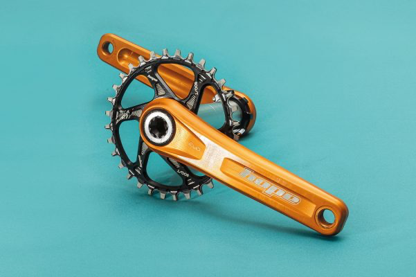

I’d love a set of Hopes but I’d rather spend that money towards upgrading the brakes at some point.

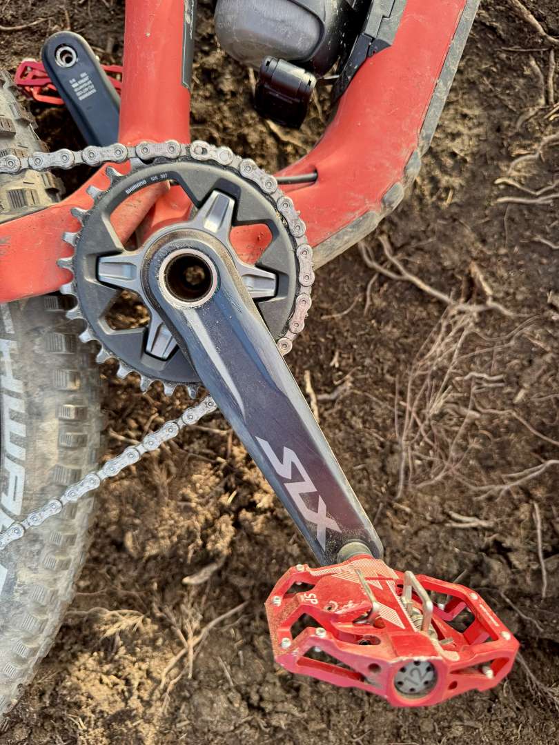

I need to get some shorter cranks to avoid pedal strikes on a new(ish) bike. Want to stay with Shimano but can't see any cheap 165mm crank deals. Anyone seen any deals that I may have missed.
Posted : 07/03/2025 2:45 pm

So the arm wasn't actually any shorter.
But the pedal is higher, so theoretically less chance of strikes. (And if it's an aluminium crank, you could just take the end off...)
Oval rings put the peak just after 3 o'clock, so logically the saddle to BB height should be about the same?
Only if you only use the front (and back) 90 degrees of pedal stroke. Rule of thumb seems to be about a 2/3rds of the change in crank length higher and 1/2 back from those few convos i've had with fitters who've dealt with this.
needs to be 10mm further back to keep your knee pushing in the same position.

Posts: 584
I needed new cranks and have a very low BB on my hardtail, so the Hope EVO 155mm were my choice.
Yes, it definitely changes the gearing - I'm going to get a smaller chainring for climbing days. I don't have short legs yet if feels fine, and somehow really planted in berms.
I do need to raise my seatpost to compensate, which seems to be seized, but that's another thread...

 P20
Posts: 4153
First ride on the 165mm cranks. Definitely better on the pedal strike issue. There were still some strikes, but nowhere near severe.
couldn’t really tell any power difference, but I’ve just come off half nights, so was tired anyway.
Good service from Bikeparts, ordered Friday, delivered Sunday!
