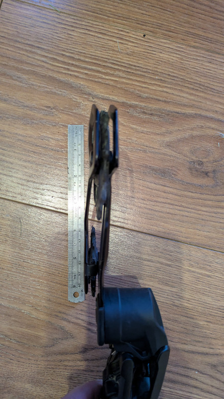

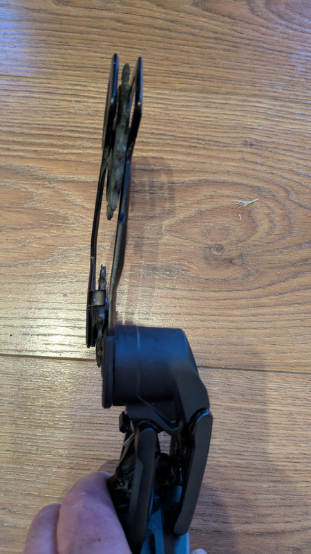

Posts: 6884
Sooo.... I think I've found the issue with my Axs... No idea why it works ok on one setup but not the other.
But this mech cage is surely bent?
Not completely surprising what with the size of this unit!
