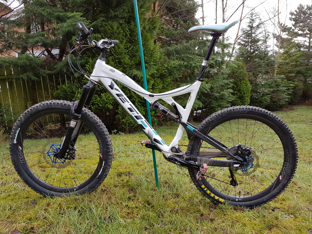

Thanks for the replies, nothing drilled and will try and find an external routed post with the cables leaving the post at near the bottom at least. The now defunct reverb had the cables all the way to the saddle which was annoying and frankly ugly.
First shakedown after upgrading to 1x11 and feels like it has a new lease of life. Obligatory photo for Chopper:

Posts: 1553
Just checked how I ran mine, yes it's not the best looking but, to be fair, I never had issues with the cable/hose routing ...
