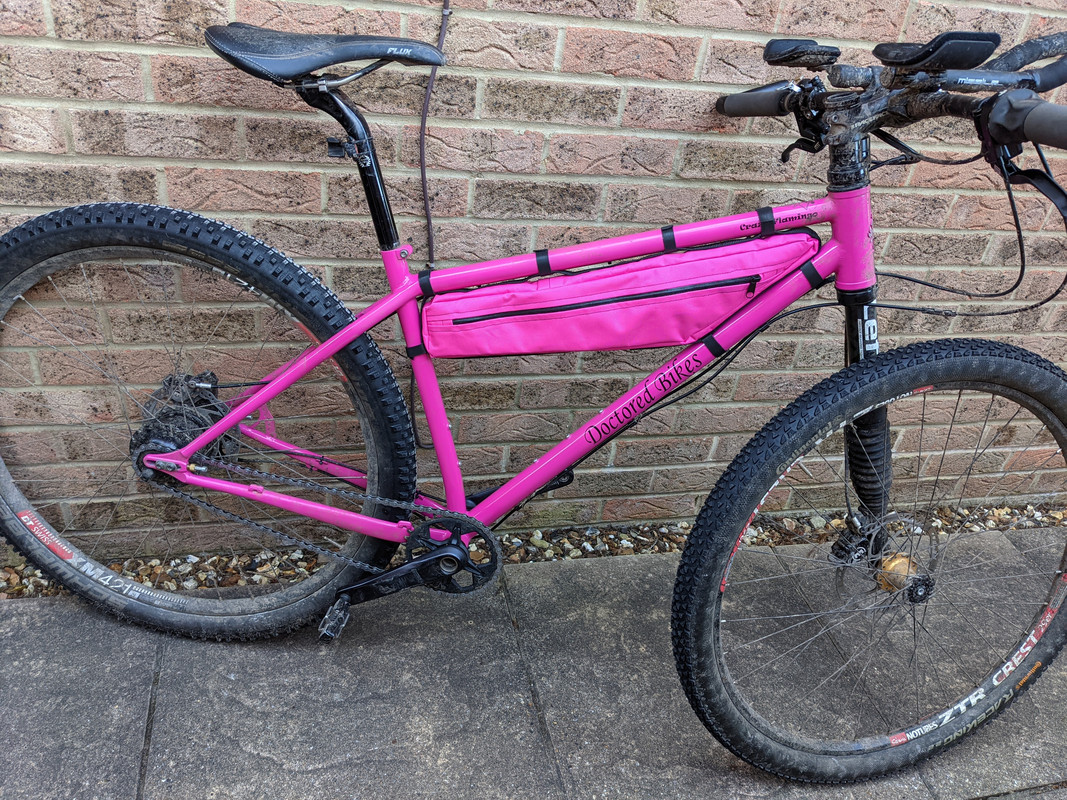

Posts: 1070
I made this one last week
Fabric
Zip
Webbing
Binding
Thread
Needles
Posted : 23/02/2021 8:36 am
Posts: 1513
I like the colour matching!
Posted : 23/02/2021 8:41 am
