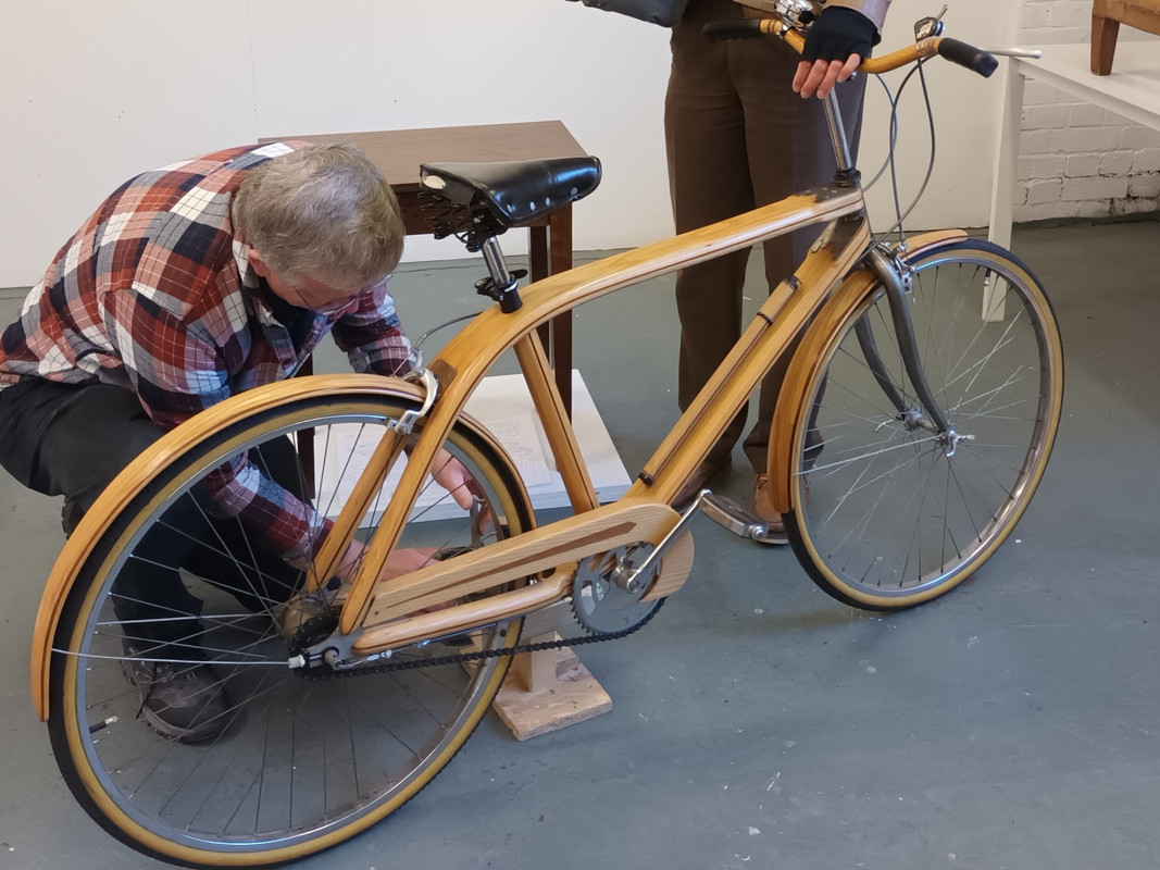

I helped one of our students build a wooden bike a few years back, it was essentially two identical laminations in ash, for the main frame elements, with some custom dropouts. We re-used the seat tube/bb and modified a headtube to bring it all together. A similar approach, possibly just using the upper frame element might make a super balance bike.Charlie's wooden bike

@chives love that!! Impressed a student did this
