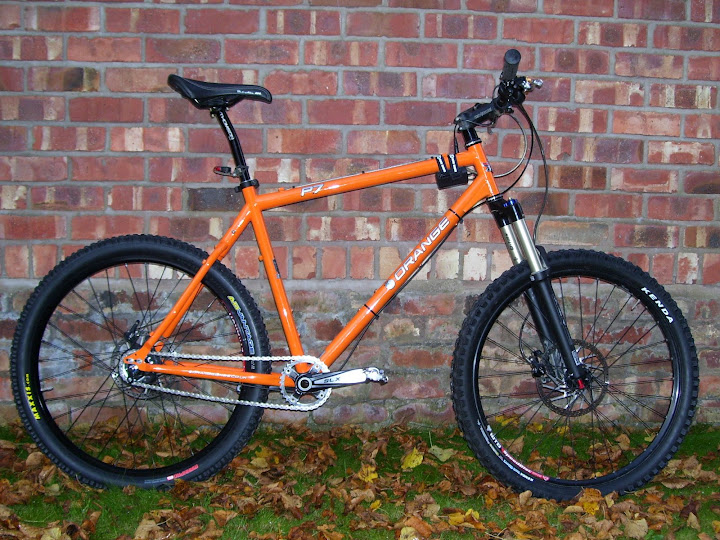

Have an alfine on a P7, lasted about a year including a fair bit of riding in winter on the edge of the peaks, now needs the bearings replacing and an oil bath. Probably still cheaper than replacing chains and cassettes though.

I have had an Alfine on a P7 for a few months, so not really had it long enough to form a proper opinion. Lovely so far though. Would have a Rohloff if I had the cash tho...
