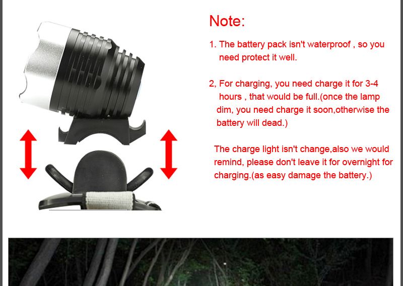

Just ordered a couple of Cree XM L T6 lights for bars and helmet. I'm thinking i could adapt the lower half of one of the helmet strap mounts
to suit the helmet mount so that i can swap between light/camera easily.
[img] https://encrypted-tbn3.gstatic.com/images?q=tbn:ANd9GcS8eVbBxleXALVuNktJp_9ZMKrDFWveTggRndVLfmvuT9VnARSgRg [/img]
All theory at present and i wont know until i get my hands on them.
Northwind, any pics of the glue/clothes peg effort?
