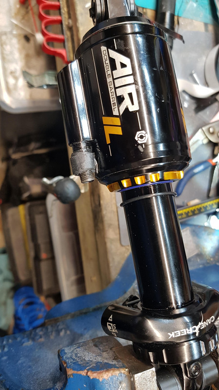

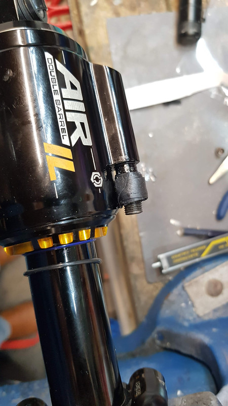

I was fettling / moving stuff about/ generally improving by bikes. I got to the stage to set sag : connected pump - stood on the peadals.
But I completely forgot there was no air in the shock so it went staight to bottomed out and of course the pump hose interferes with the shock body and properly twisted the valve stem!
Leaving a crack in the stem. It is on the non pressurized side of the valve core: ie if I get air into it: it will stay in there.
I have tried a few things so far: Araldite, heat shrink on the outside....: I can get it to about 90psi before it starts to leak, which is way too low.
I'm reluctant to spend much cash ATM - and cant find anywhere with the part in stock anyway.
So - any ideas : repairs or something to replace it with given its on the non-pressurized side?
Any help appreciated.
*Edit : forgot to say - the stem is removable: and the thread on both ends appears to be the same: ie standard schrader

I have removed the stem from the body already: the photos were after I reinstlled it to test my last failed repair attempt.
