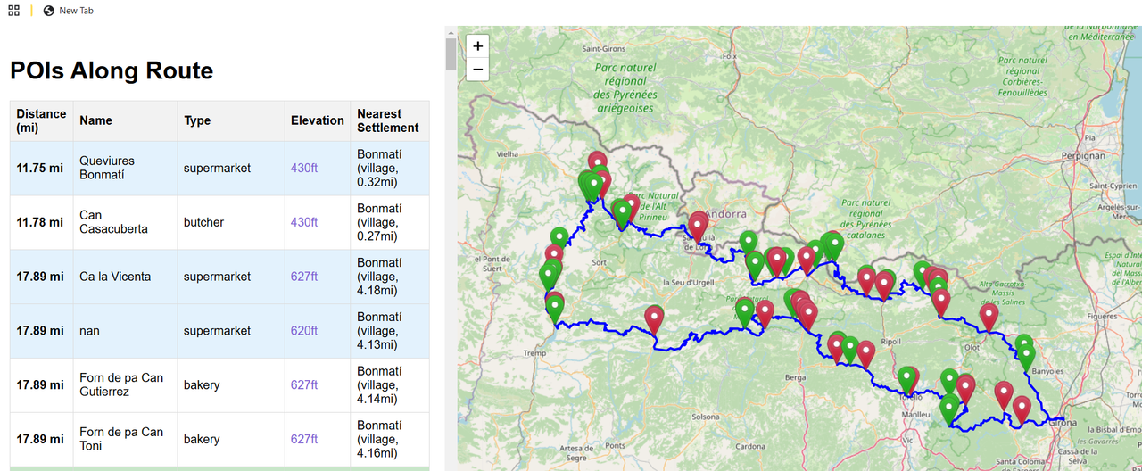

I was bored after the kids bedtime:
https://github.com/mrhoney81/routethink
So far it will take a GPX route:
breaks it into chunks if it's a long route (like 500k or whatever)
creates a buffer round the route (user definable, defaults to 500m)
finds all the settlements defined as village or larger (hamlets and such nonsense are excluded)
takes each settlement and queries whether there are any shops or campsites within 500m of the centre of the settlement.
dumps it into a csv and a html where you can click on the links and have it open up google maps.
E.g. for a random 130km route to Glastonbury from near Newbury.
Seems to work!
This took less than an hour and I didn't write a single line of code. The age of custom software is very close...
Posted : 05/01/2025 7:18 pm

I think now i've (/the AI) built that, I actually steered it in the wrong direction. I focused on finding the settlements and then finding the POIs near those settlements - now i've seen how the APIs work, I should have just created searched the polgon for the POIs of interest rather than those near the settlements. Most of the time you wouldn't care if the campsite is in a village or not.... e.g. in my example it finds no campsites in Glastonbury, because it's querying 500m from the centre of Glastonbury - they're all on the outskirts.
Posted : 05/01/2025 7:22 pm

Well in the 13 minutes since I posted that, I just gave it the code based i'd already written and said actually i've over complicated this just create and search a buffer zone for the actual POIs - and it did it. Much better approach actually.
Updated the git, but now it looks along the route (500m by default each side) and finds all the department, grocery, supermarket and campsites. It then finds the nearest gpx point to that (to find how far along the route it is) and then uses that to order them. Should work well in spain since OSM is good there (better than the offical maps in my experience of climbing!)
Posted : 05/01/2025 7:40 pm

Forgot you wanted altitude as well. I've added that and the nearest settlement to each POI
Edit: it's the better_search_poi.py that is the one you want (unless you want to go down the rabbit hole of my first approach).
Posted : 05/01/2025 7:49 pm

Ok last update (my wife has finished putting child no. 2 to bed now!)....
I've added an interactive map, where you can click on the link and it zooms into the shop or whatever, also provides a link to google maps so you can look at the satellite if you want (I would 100% be verifying my campsites at least!).

Version one looked like this for me - exciting!
Distance (km) Name Type Elevation Nearest Settlement Location
0.04 km Oriell bakery [80.0]m Sant Gregori (village, 5.58km) 41.98263, 2.822857
0.04 km Rigo butcher [80.0]m Sant Gregori (village, 5.5km) 41.984293, 2.8222262
0.04 km Pecat Original supermarket [79.0]m Sant Gregori (village, 5.53km) 41.9845461, 2.8226186
0.04 km nan supermarket [79.0]m Sant Gregori (village, 5.52km) 41.9845254, 2.822547
Posted : 05/01/2025 8:31 pm

No worries! Let me know all the ways it doesn't work lol (in case it's not obvious nan means that no value is held for that variable - e.g. if OSM doesn't have the name of the butcher it'll write nan).
Posted : 05/01/2025 8:35 pm
Posts: 241
Thanks - I remember now that something like pandas does that nan thing now you mention it!
I've got your code base up in cursor ai, I changed the measurements to imperial just to see how it all works.
Initially I got an error, I pasted the error into the chat and it offered up a fix which I accepted.
And asked for changes like this -
Make the ignore two parameters - ignore first x miles and ignore last x miles
"I'll modify the code to make the ignore distances configurable parameters. We'll add them to the main function and pass them through to where they're needed. I'll modify the code to make the ignore distances configurable parameters. We'll add them to the main function and pass them through to where they're needed."
It's just...brilliant!!!
Posted : 05/01/2025 8:59 pm
Posts: 241
I will refine it a bit more then check it against a real map before trusting it of course 🙂
(Thinking I'll add hotels, compress to a list, look for some more API's like population count on towns, add a "handlebar print" mode that kind of thing!)

Nice! Feel free to submit the changes to the GitHub. That's all integrated in cursor too.
Posted : 05/01/2025 9:40 pm
Posts: 241
I will do cheers!
I'm thinking to ask it to put all the parameters in a toml configuration file and a few other things!
