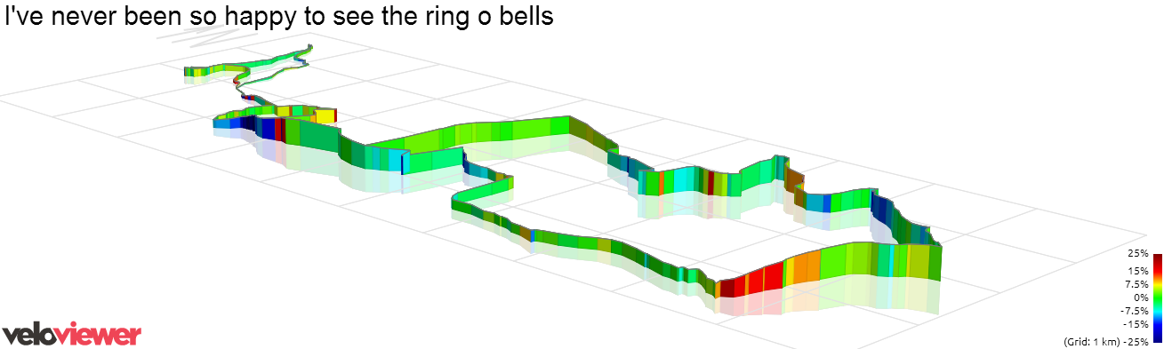

OK so i'm a pansy, I get up everything in my 24/36 and wouldn't want anything smaller to drag me and the Mega up the hills.
24/36 gives me a 'winch' gear of 17.8 inches which is the same as 28/42 - does that sound right?
Here's them hills :/
