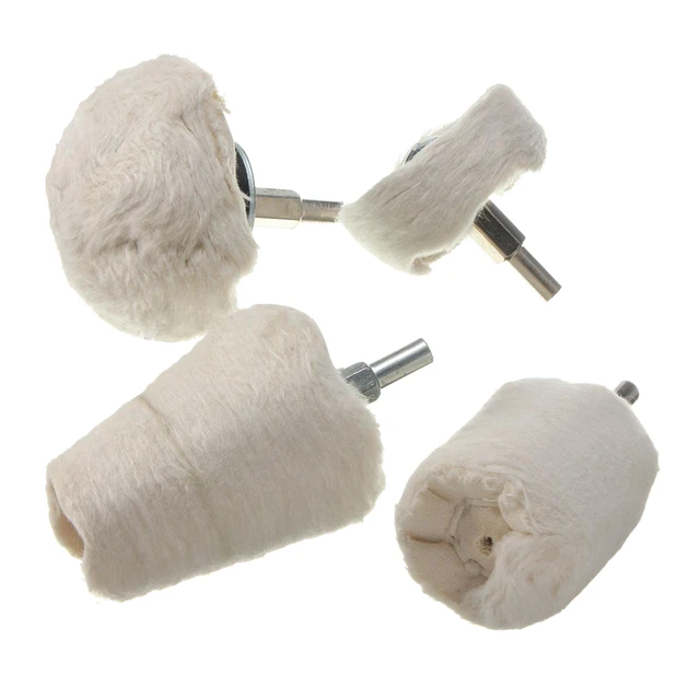

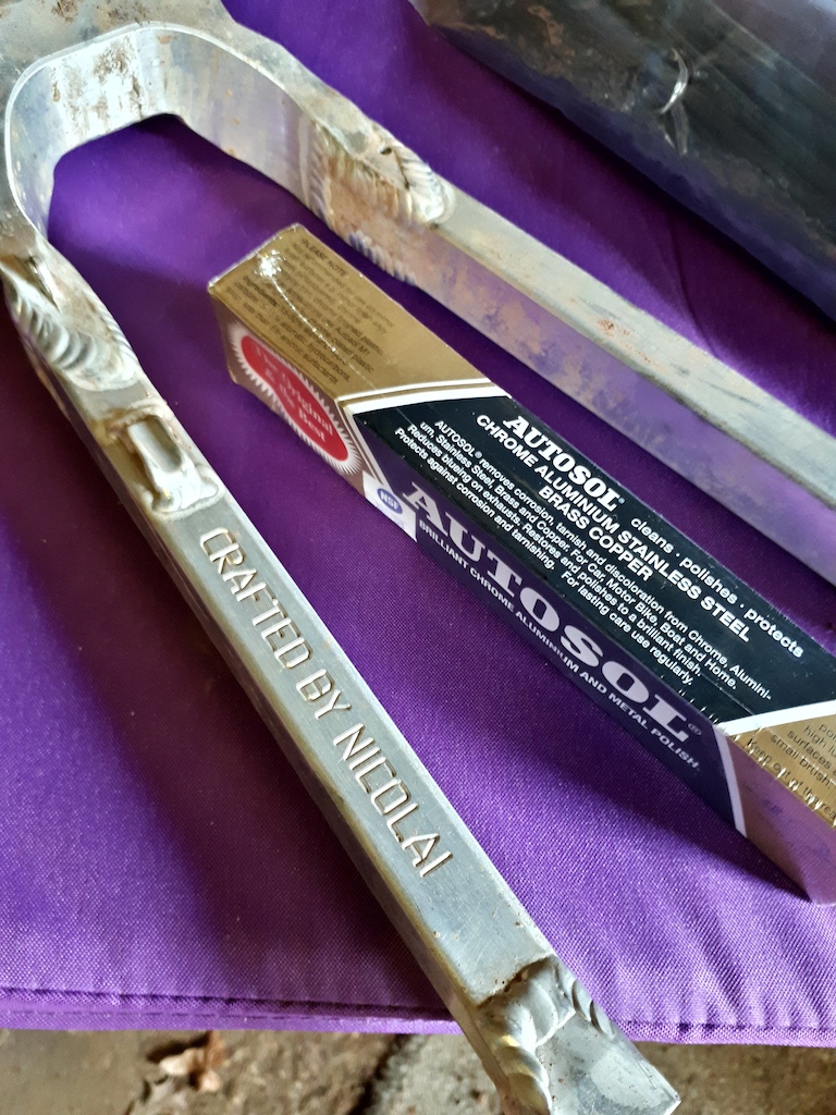

Posts: 923
Various polishing bits in a drill or Dremel, some Autosol and lots of time and patience. Assuming there are no scratches, then it's time to break out the wet and dry, in ever decreasing grades until the scratches are out. Then back to the first bit I mentioned

I got some Autosol and a bag of mops for my drill from eBay. It was easy but time consuming. Obviously the more time you spend on it, the better it looks.
The problem was that it doesn't stay shiny. It quickly goes dull and because the surface isn't smooth it fills up with dirt and looks stained and brown all the time. Maybe I should have clear lacquered it.
I loved mine when it was rebuilt but it looked like crap after a few months and I ended up having it power coated.
