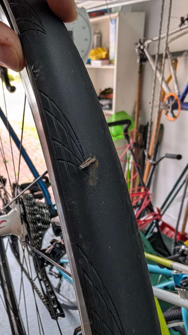

Minor updates, was disappointed to find my road bike with a flat rear tyre this morning (RideNow 36g TPU).
However given the size of the staple I pulled out, and the fact that it didn't go soft immediately (I think I know roughly where I picked the staple up) I'm pretty pleased. Stan's has repeatedly failed failed to seal smaller holes at lower pressures on my gravel bike!
