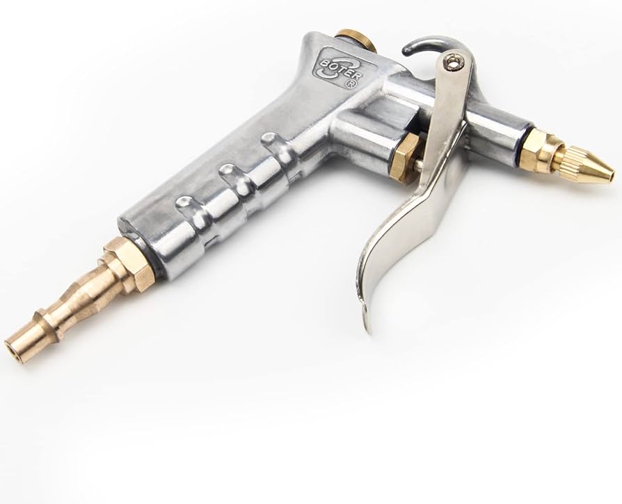

Buy a cheap air gun to go one it. More air comes out. They’re dirt cheap (£5 to £10) and good for cleaning out all the nooks and crevices in the car/van as well.

I bought one of these for my compressor and attached it after the pressure gauge on the car pump fitting. Works a treat.
https://amzn.eu/d/gf4mkUK

Remove the valve and use a basic air blower gun
