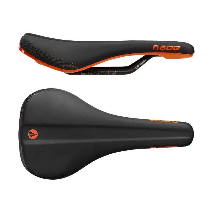

MTB only, but (despite a generally high'ish saddle to bar) I pretty much have them flat.
Currently got a Bel Air V3 on the ebike though and can't decide if I'm getting on with it - I spend a lot of time sat right at the back of the saddle, so the upturn feels a bit weird
SDG-06332
