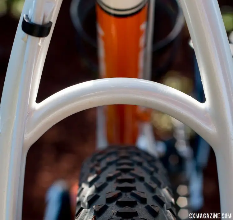

funny where a couple of clicks gets you! from the raleigh, to the G1 tyres, to this:
http://www.cxmagazine.com/handbuilt-bike-profile-anderson-custom-bicycles-29-cx
clearance with 2.2 race kings - 29+cross?
