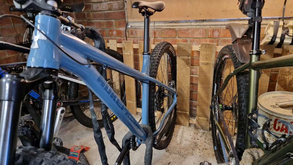

Posts: 11476
I tried a floor mounted rack like the pics above but the bikes wobbled/leaned and seemed to put a lot of stress on the wheels, the derailleurs may foul (especially 1x on a 26er).
I built a wheel support rack against the wall from pallet wood, you can change the spacing to suit different tyres (and change the gap between each bike) to your heart's content with just a screwdriver/drill driver, make them slightly wider to allow diagonal storage.  The only thing it doesn't like is bikes with full mudguards so they have to go in front wheel first.
Space the slats off the wall (I think mine are just the depth of the brick piers).  I put a humoungous 10*4 shelf above the bikes to pile all the crap out of the way and an extra light under the shelf so you can admire all the mud that falls off!
