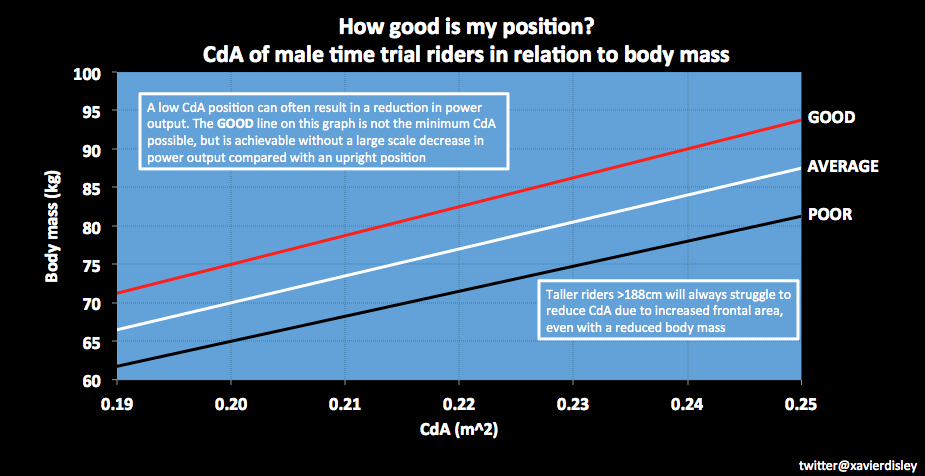

I can appreciate the marginal gains in TTing though.
I do need to do some work as I'm currently pretty much bang on the "poor" line here at the moment...
I know of some people who aren't even on the chart their CdA is so low. Aim is to get to "average" this year.

Aw, shame. Looking at that graph, as I'm 194cm and 85+Kg, it's pointless trying to get good at TT however budget I go. I'm stuck with a life of single track and bike packing.........
Posted : 14/02/2016 8:14 am

How about this for budget? An estimate of CDA for less than £80. I use a powercal heart rate monitor that estimates power. For TT efforts it isn't bad either. When run on short circuits I use Golden Cheetah's aerolab to estimate CDA.
I was as surprised as anyone to see the power curve match up with elevation power and give ANY estimate at all! But it does just fine. Run it with the trike too.
Now that is budget 😉

Blimey if you can get any reasonable data from that I'd be quite surprised! My PowerCal isn't anywhere near sensitive enough. Do need to find some time to play around with Aerolab though.

You need a good circular route of a few miles, about five laps and a decent but not maximal effort. Then air density from weatherPro and a guess at tyre resistance. Add 50% for the trike. Probably not to be compared with other power meters, but ok to look at changes in position.
Posted : 14/02/2016 10:50 pm
Thanks TiRed. I've read up quite a bit about AeroLab and keep meaning to give it a go. Quite a few threads on it over at the time trialling forum (yes there are other forums!) with some quite varying views. Sounds hugely time consuming to get decent results... but then when you put potential gains in terms of watts it seems a lot more reasonable.
