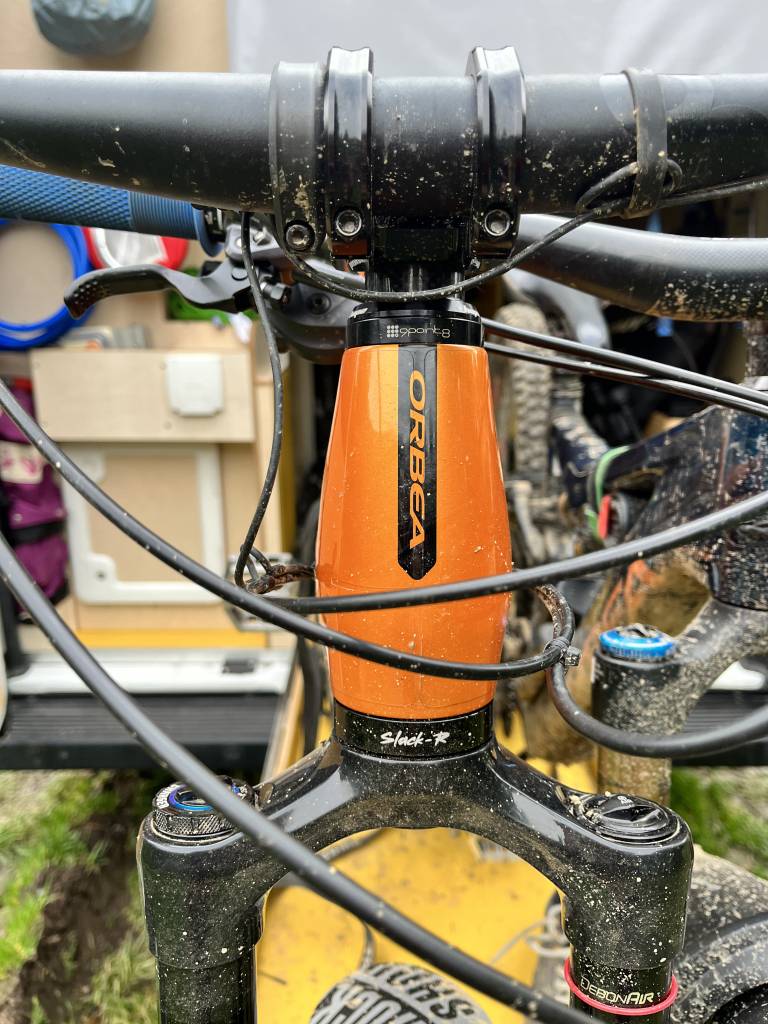

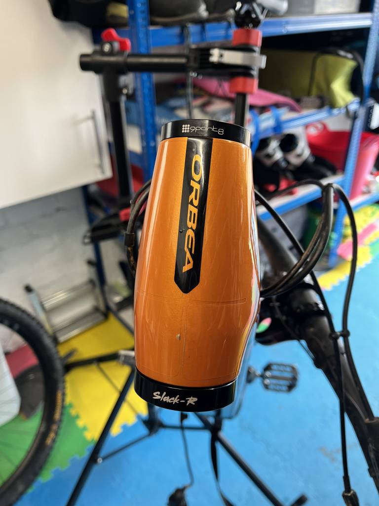

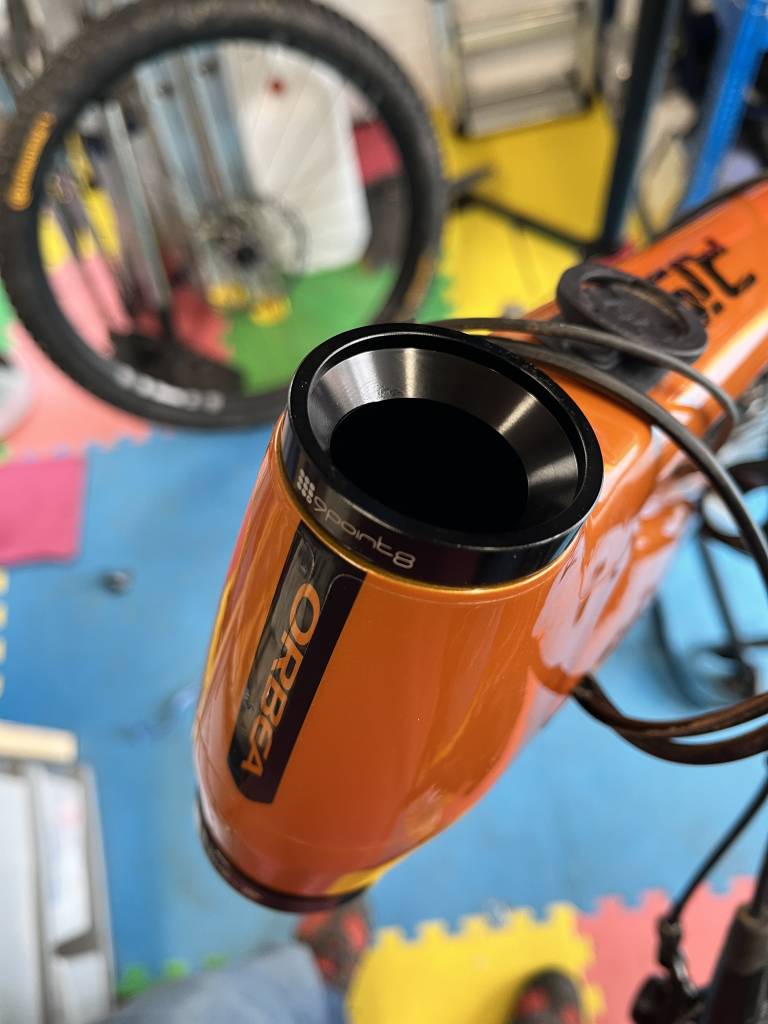

well it’s in. I did have to sand some material away from under the top bearing seat (don’t tell Orbea) which I didn’t enjoy but was easy enough with a dremel.
Fitting after that was relatively straight forward. I didn’t take any before / after measurements or photos but it does “look” nicely slackerised. I’ll see how it goes, fingers crossed it doesn’t spin or creak.
IMG_4547IMG_4549
Posted : 29/09/2023 10:57 am
Cool, neat job 👍
Posted : 29/09/2023 10:59 am
Posts: 4324
So first ride today, worked exactly as expected and the bike was great
 But…
the bottom cup spun 😔
I’ve tightened it back up and will try again tomorrow, but if it spins again it’ll be coming out and getting sent back. Which would be a shame.
Posted : 01/10/2023 8:27 pm
