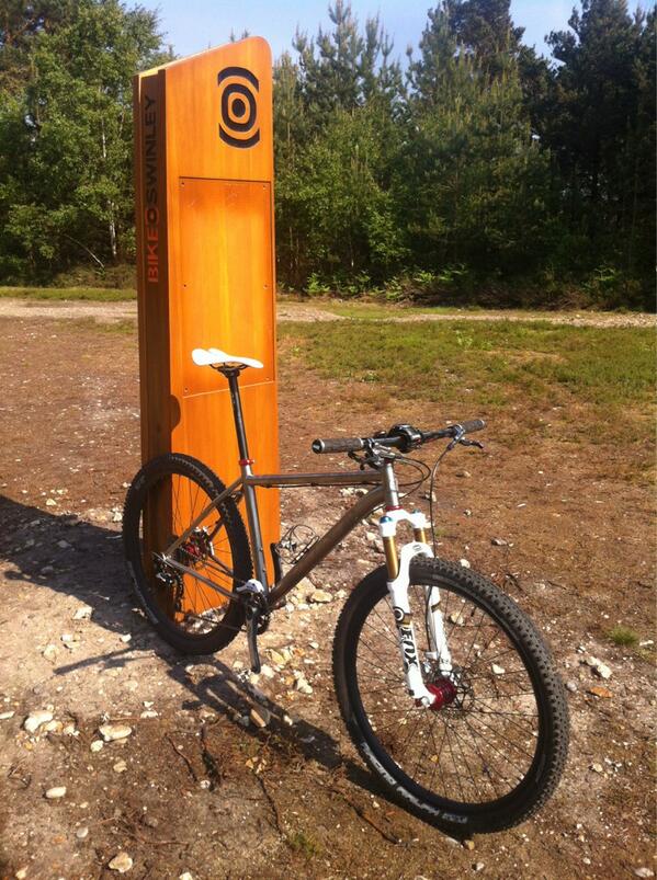

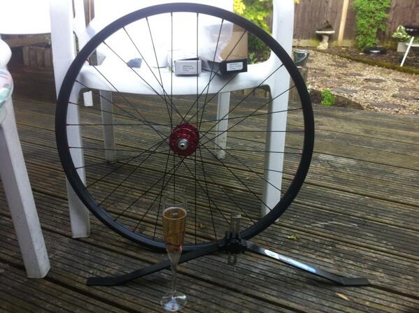

So after many months of reading the reviews on MTBR, I went for a pair of the Light Bicycle carbon rims from China at £135 each delivered. They were shipped a week after I ordered them and arrived 9 working days after shipping. All good from start to finish. Excellent email communications.
They arrived yesterday, 3k weave, 32h, 372g and 380g. Absolutely perfect finish inside and out. They were very easy to build up. They went up tubeless just as easy as a Stans rim - I used a couple of layers of insulation tape and the usual valve.
First ride tonight and wow - they are stiff. I wasn't sure they were worth the money riding them to work on the road this morning, but round fast berms and corners where you are really leaning into the bend they just don't flex like a Stans rim. Stans feel really whippy by comparison. I ran my usual pressure and had no tyre roll or squirm at all. A really noticeable difference. I guess this could be due to the wider rim profile compared to the Stans rim, though.
Now let's just see how long they last....
Some pics of the build, of the bike with the new rims, King hubs, new XTR discs and some nice wider bars too as my old ones were damaged. Ison also had some custom Sala/MTFU ODI lock-on grip lockrings made... Just about the most awesome thing I've ever seen.

Nice. Which Stan's rim are you comparing them to?
Posted : 07/06/2013 7:31 pm
 gee
Crests.

They seem to be fantastic rims. Fingers crossed they stay in one piece now. They'll get quite a hammering racing so let's see...

Lockrings not available to buy - limited supply... Frame is now in it's 4th season of racing... Got to love titanium.
If you go for the 26" ones make sure you get the wider ones. They do 2 widths. Actually, before you go for 26" at all check 650b wheels won't fit in your frame/fork...

The wheels are 1640g the pair. King hubs, Halo DB spokes and DT alloy nips.
As long as they turn out to be durable I want more pairs for my other bikes! I was really surprised at how different they felt round berms - so much stiffer. What has also sold it for me is the ease of getting them tubeless.

I've been hammering a pair of the 29er versions on a rigid singlespeed for the last 5 months and they have been absolutely spot on.
They are in a different league stiffness wise to Crests and weigh about the same,mine were approx 380g each. Also just as easy to set up tubeless as Stans rims.

The update is I've caned the hell out of them at Mayhem (9 laps), one long ride and an XC race. The acceleration is a lot more direct and the tyre definitely doesn't roll as much. You really notice it on fast bends and when you give it the beans down a fire road. I've bottomed the rear a few times on roots but they are still in one piece. It makes a really odd noise when you do this though... I'm going to keep racing them for this season then make a decision on kitting the other bikes out when I've seen their durability.
Re flexy Stans wheels - I build my own wheels and have done for 12+years so I know they are built the same as my Crests. The carbon ones are a hell of a lot stiffer.
Right now, I'd be gutted if I'd just spent £800 on an Enve rim.

Update on the rims... It was the National XC at Margam PArk, Wales, this weekend. The course was loose and rocky with some big drops/roll ins and some really bumpy sections, so the rims took a real hammering over the 2 practice laps and 7 race laps. They are fine...

Don't suppose you can remember what spoke length you used gee ?
I am going for the same on king hubs.
Posted : 10/07/2013 7:45 pm
Posts: 751
Was gonna ask how they held up. Might add them to the shopping list now...
Posted : 10/07/2013 7:46 pm
 gee
272/273
Shorter ones on the drive side on the rear and disc side on the front.

They only do the 650b in 30mm. I'm also going to order the 29er in this width as the tyre is so much more stable and they are only a few grams heavier.

They are still looking new, are perfectly round and have been raced all season in XC and 6hr/24hr races.
