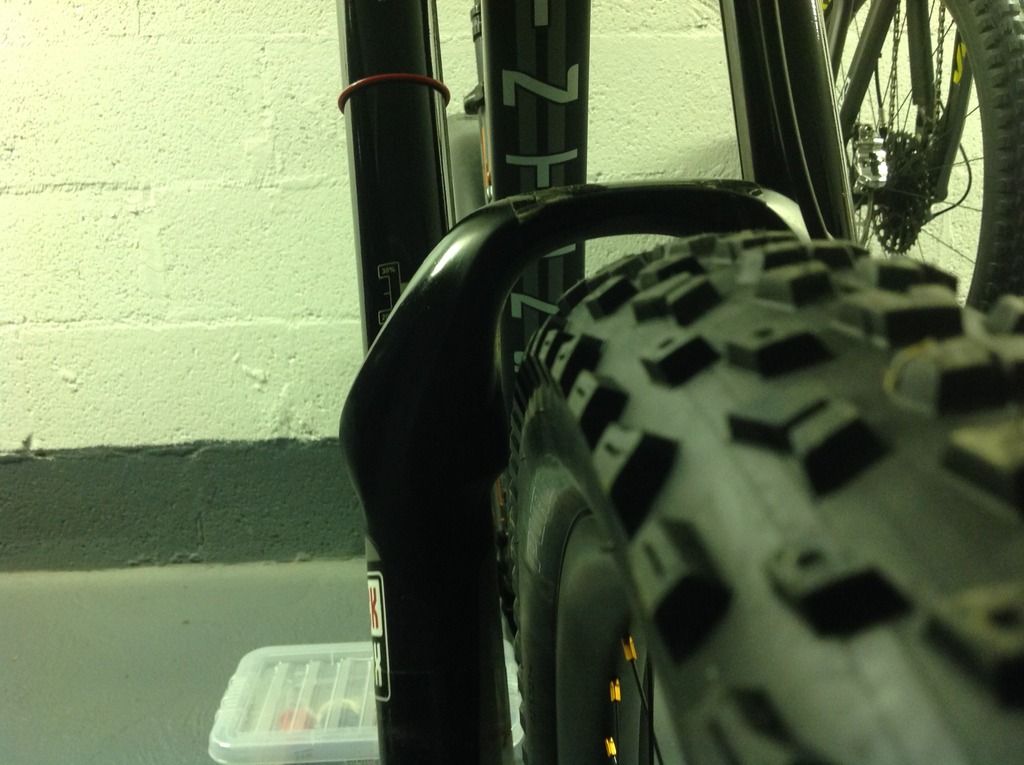

A Spesh Purgatory 3.0 in a Pike 29er fork. The tyre is mounted on a fattie rim, 29mm ID, and is inflated to 20psi.
Sadly the same set up out back on my Enduro is super tight to the driveside chainstay. I could fettle with the dishing of the wheel to give me an even gap but it would still be close and would only be usable in dry conditions.
Posted : 17/11/2015 7:21 pm
Well that proves pikes have a good bit more clearance than revs.
Posted : 17/11/2015 7:34 pm

@mbnut thx, it's hard to tell from the pic - are you happy that's rideable? Good news if so.
Posted : 17/11/2015 8:31 pm
A better look at it.
I would be happy with it in the dry for sure. Wet, loose mud and say trail centre grit type mud would be fine too I reckon. Sadly I live in a chalk and clay area so that would probably scupper its chances around here.
For the record the tyre comes up very similar in size to the Vee Crown Gem 3.0 i'm running in a 140mm Sektor 29er fork.
I have a Fox 34 that i'd like to try them in as well but that'll have to wait for another day!

Finally got my purgatory and have it on my 25mm internal rim.
Interestingly the actual tyre carcass is very similar in width to my trailblazers but while the tb knobs don't protrude beyond the carcass, the purgatory ones do significantly and as such they look a lot wider. So that's a carcass width of approx 65mm. With the width including knobs nearer 80mm.
I tried the purgatory in my Reba and it's basically zero clearance. Certainly not rideable.
Posted : 19/11/2015 10:16 pm
Posts: 920
Thx for info. I measured my Pikes at about 72mm at the pinch point, so no go really. Rats.
Here's hoping the 2.8 Nic comes in.
Posted : 19/11/2015 11:04 pm
I remeasured the Purgatory and I reckon it's more like 72 or 73mm including the side knobs.
It seems to sit fine on the 25mm rim which given what appears to be the same size carcass as the TB is no real surprise but I haven't ridden it yet.
Posted : 20/11/2015 11:47 am
