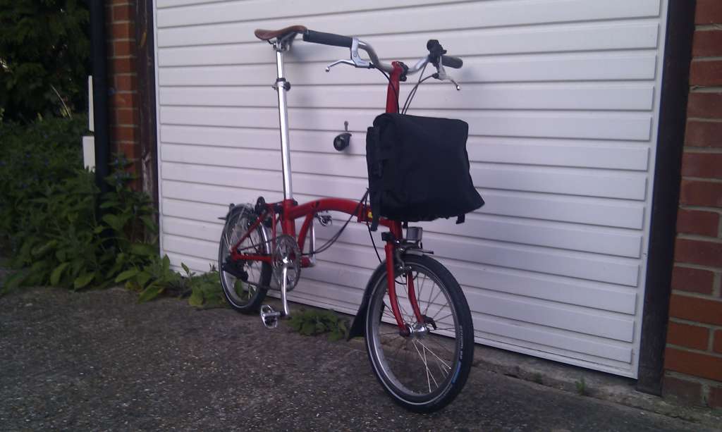

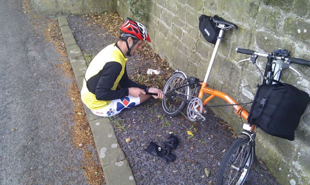

prior to my current six speed, and for Lejog (wow back in 2011 - how time flies) fitted this Stronglight double for a kick chain down and lift back on with finger, as did my riding buddy - here him fixing one of only two punctures the whole trip
Brompton1
Brompton2
worked well.
