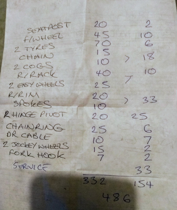

It's knackered - not helped by getting hit by a car. There's quite a few bits that add up - front and rear rims (so wheel builds needed), new drive chain (front ring, chain, two speed sprockets, jockey wheels on the gear pusher), gear cables (they're split) new rack (all 4 stays have broken), Needs new tyres, brake blocks, couple of new frame hooks, new seatpost. Some work on the rear hinge.
Some of this is definitely convenience tax stuff, or to be honest not needed, like the seatpost - its fine.I can replace the stays on the rack rather than getting a new one (I've snapped a bit of it and re-drilled and fitted an easy wheel so the LBS doesn't like it). I can buy tyres cheaper online and obviously swap them myself. Dunno.

Thanks all for the opinions/offers. Collected it from the LBS on Monday, just for interest here's the breakdown:
From that its not as knackered as I thought, that's mostly consumable stuff that adds up. Not sure I can rebuild a rear wheel, or sort the rear pivot but everything else is do-able by me. Seatpost, tyres, front hook are all OK - will need replacing at some point but OK for now.

Building wheels is easier than you think, just read Sheldon's guide, take a deep breath and go for it. If it's only a rim swap it's easy and you shouldn't generally need new spokes. Plus, Evans quite often have Brompton rims and spokes (and some of the other bits on your list) on sale for buttons in their ex-display section. Nothing at the moment by the looks of it, though.
