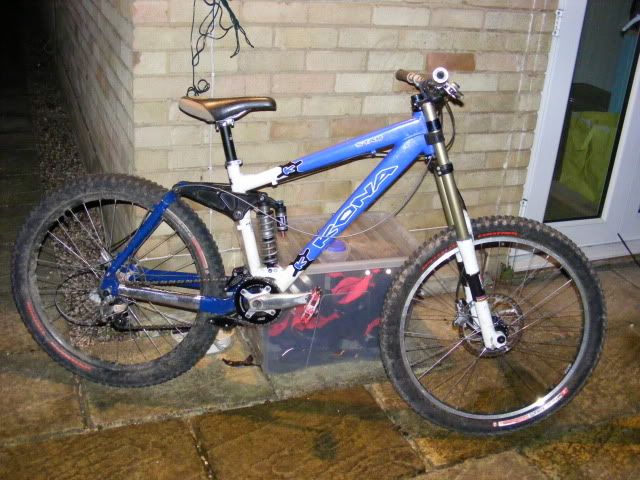

offset bushings are a cheap way to slacken out and older steeper HA frame, throw in a shock tune for your weight and you can get a very nice feeling bike, thats what I did with my stinky and it makes a big difference
Posted : 02/05/2014 11:27 am
Posts: 15261
Ditto on that Stab above, and I extended the fork down in the crowns a bit to slacken it further and help hold the front up on steeps (that's a rather old photo now)...
