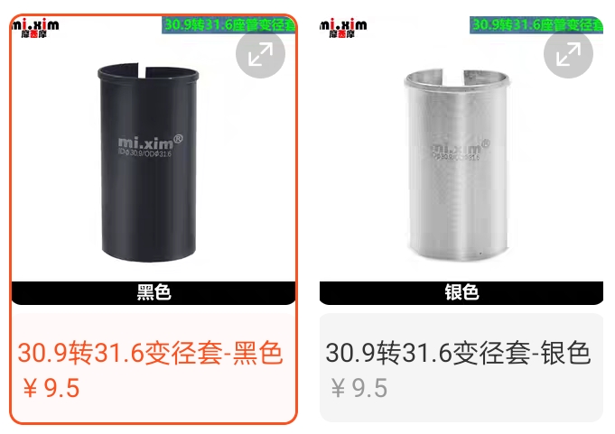

I've noticed recently in the Chinese markets that shims have started appearing for 30.9-31.6mm dropper seatposts.
You can go bigger, but not smaller obviously. This kind of puts your money on the smaller diameter seatpost in case you change frame later on. If you buy the larger diameter post then you're restricting yourself.
Have these managed to reach the UK market yet?
Screenshot-2022-08-17-09-56-21-15-090d9ae461b065ca11c329abb9cd0d70
Ps. I have one of these still in the packet at home. I bought a 30.9 dropper post and shim and then the 31.6 frame I was after went out of stock and I managed to get a new run 30.9 different one.

A lot of Giant bikes used to have 30.8 mm seat tubes with a shim and 27.2 mm seatpost as standard.
Those shims in the pictures look pretty short. I've always taken 100 mm long as the minimum. Good quality shims aren't expensive, no point buying a cheap one that's too short.

I think it's easier to stop slippage with a shim. Shims have a lip on the top so they won't slide down into the seat tube. You can grease the outside of the shim to make it easy to remove from the frame without any problem of it slipping. You can sand the inside of the shim (and the contact surface of the seatpost if necessary) with very fine sandpaper to remove the shiny finish, then degrease it. I find that if you do that, you don't get problems of slippage. If you did that without a shim, you'd quite likely have a problem of the seatpost bonding to the frame and being impossible to remove.

Only thing I’d add is I always look for a shim at least 100mm long. Always worked fine for me.

I recently got a Brand X shim from CRC for £4 to fit a 30.9 post in my Starling, which has a bit of distortion in the seat tube making it difficult/impossible to full insert a 31.6.
Mildly annoying at the time, but in hindsight a wise move because it should also limit the potential for the post to fuse with the frame.

Agreed, though my current frame only specifies 80mm of seat post. I bought a USE one, as they seemed the longest (easily) available, at 100mm iirc. When I sent one dropper off for service I was able to move another across to my main bike with a shim. If you were spending the money on a RS AXS dropper (or any realistically), I’d buy the smallest & shim up if needed, so you could move it on to your next bike
