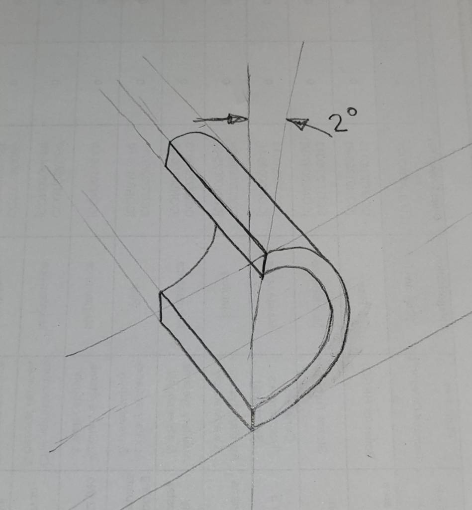

I need a 22.2 to 31.8mm handlebar shim. These only seem to be available from US bike shops and I reckon this is an ideal use case for 3D printing.
Would any of you owners be kind enough to make me two of the below? Obviously beer tokens or a donation to your favoured charity would be a fair exchange. Thanks.

To hold your handlebars? (presumably BMX/Cruiser bars?)
Nah, I've done a couple of seat post shims in PLA and they're still working fine, but the worst case for their failure is my seat post slides down and I look like a tit. I'm not sure I want to help you with your DIY dentistry project...
Good luck...

3d printed in metal maybe, but I think there's too much risk that plastic will alter properties too much under compression and with varying temp.
I wouldn't.

Agree with @cookeaa, not sure plastic is the material of choice here
Cheap BMX stem a la Charlie's Karate Monkey might be a safer solution?

Bet you someone with a lathe would knock you it up for very little; bit of 1-1/4" bar stock, bored out and parted off, you could just (neatly) hacksaw it down the middle and file to finish...

Yeah, PLA really isn't a good option for the amount of torque and load it'll need to hold. Even on something like 100% infill, i just wouldn't put plastic between bars and stem.
(this is an ideal usecase for a friend with a lathe or mill, and a piece of metal. subtractive manufacture, the math still checks out).

Fair enough chaps, appreciate the thoughts. I assumed that a bit of distortion into the faceplate cut out and working in compression wouldn't present too much risk of failure. I'll find another solution. 👍
infovore - spotted those, (SJS is my goto place for unusual bits). I need a smaller ID. You can get 22.2 to 24.5, but stacking multiple together definitely feels like a big risk of slippage.

I'd happily knock one up on my mini lathe for you but the speed potentiometer is broken so I can't do it until the new one turns up.
Don't you need 2 pieces rather than the 1 in your diagram?

That's kind of you Murray, If I don't' get sorted I'll maybe get in touch with you in a few weeks.
Don’t you need 2 pieces rather than the 1 in your diagram?
Yes, but identical so I didn't draw it twice, or as cookeaa noted a tube of the right ID/OD and I can cut it in half with a hacksaw.
