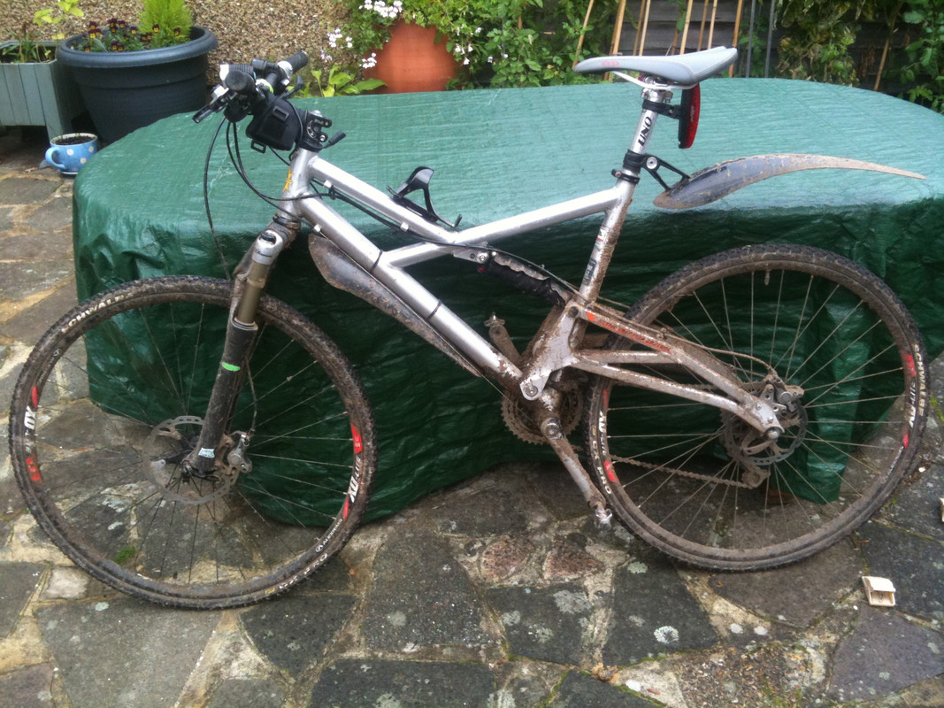

Posts: 1305
Yeah I had an old 26 inbred donated to me a few years back. It fitted 29 wheels with 36mm cx type tyres just.
Was more fun with proper tyres on 26” rims though
Posted : 26/10/2022 9:28 pm
From back in ye olden days.It was bloody excellent in mud.
