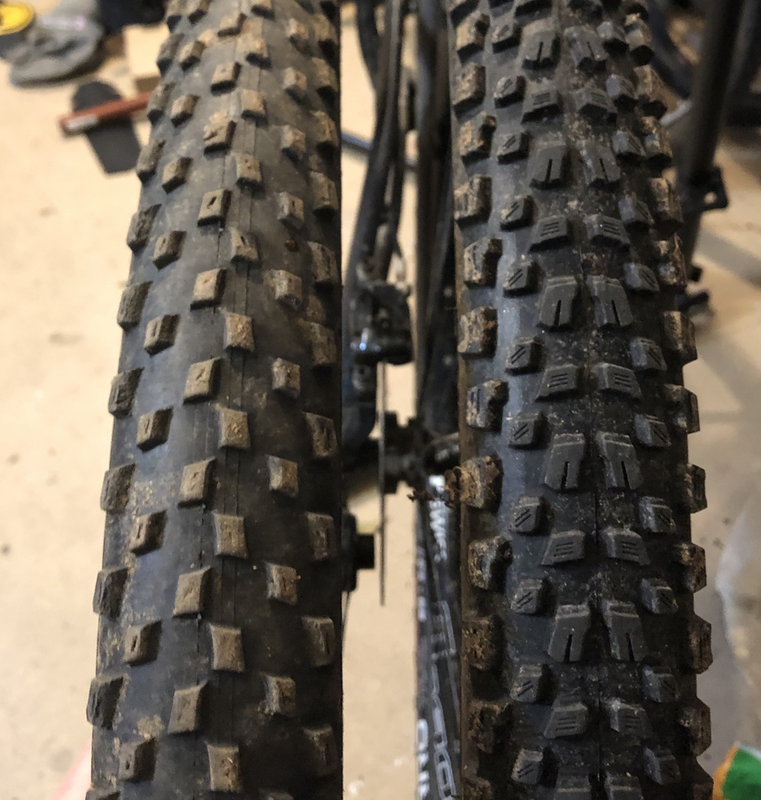

Actually have an SS already but found the 2.3 on the 29mm internal a bit draggier than expected. Wonder if I am running on the side lugs a bit.

I've been running the new super ground Nobby Nics (2.35) since January. I was a little dubious as the old versions were awful. However, these are completely different, they roll fast, grip is predictable, the sidewalls are tough and the side grip is superb. Have done hundreds of miles on them now from the worst winter weather through to the couple of dusty days we had in early May and they've been consistently good. Not cheap at £59.99 each though - if you can find any!
