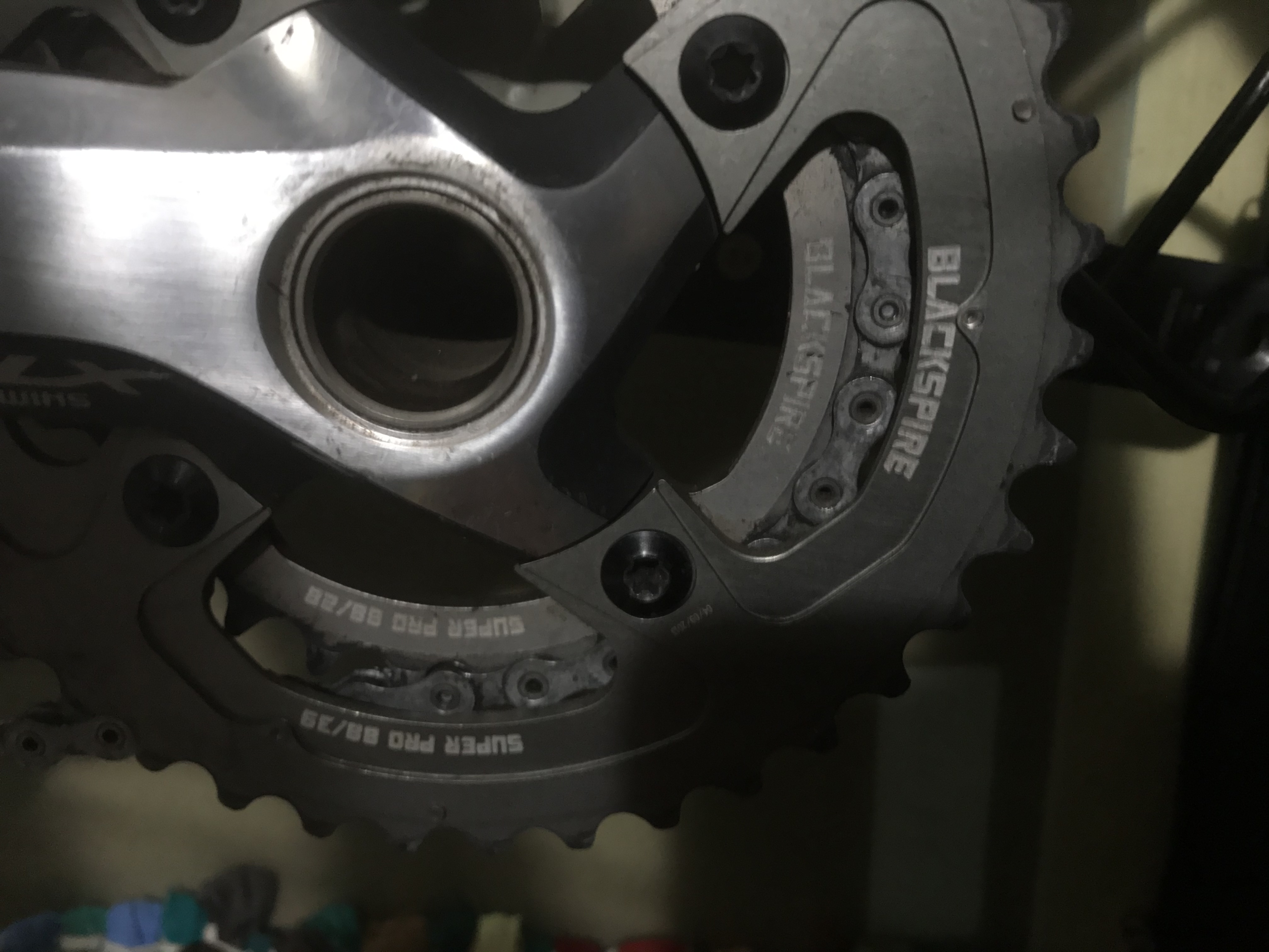

Yep. But then it wouldn’t halfway replace the SS hardtail (project brief) for the mountainy stuff. I could even keep it geared and ride in one gear. Keep sucking the pastille, so to speak
The other option would be to sell my spare Tora forks and Alex front wheel for say 70 quid (?) then use the cash to buy a cheap alu 26er frame and a chain tensioner then rebuild the hardtail with the old bits.
Finding a cheap 26er frame that takes 140/150 Sektors and has decent rear tyre clearance could be an issue.
Same amount of money might get me an 88 BCD chainring for the Longitude, I already have spacers and 16T cog. It could see me right for ATB riding until such a time I can raise money for a plus wheelset.

Thanks for all the replies, really helpful. Weighing it all up I’m still uncertain which way to go. Paralysis! One thing is for sure I gave to go singlepeed on the Longitude whatever so will get on with that. 88 BCD being an (of course!) a rare and therefore more expensive option I wonder if I can’t use the existing Blackspire 10spd ring (28T) rather then shelling out for narrow wide?

Can’t see why that wouldn’t work @p7eaven, narrow wide has very little if any benefit on a SS assuming you get the chain tension right. I’m running XT cranks with SLX 30t ring and a SRAM PC1 chain, and I think a Surly cog. Think any 8/9/10 speed chain would work though.
