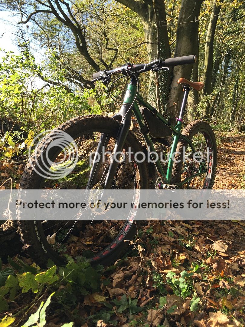

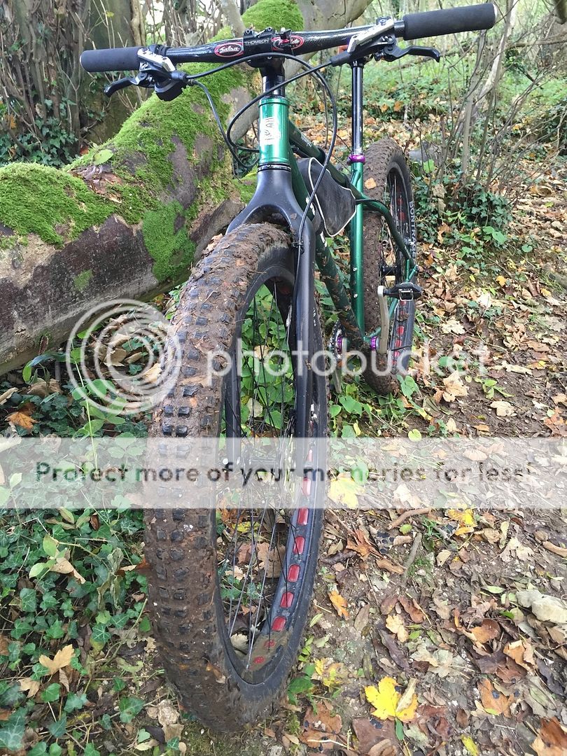

KM79, I have a pair of On-One Carbon Monocoque Forks on my Krampus. Clearance is quite tight but ok with the stock 3" Surly Knard tyre, but they work very well with the slightly narrower Surly Dirt Wizard I currently have on a 50mm Rabbit Hole rim, and a Bontrager Chupacabra fits well too (both much better all-round 29+ tyres than the original Surly Knard in my experience).
These ones:
[url] http://www.on-one.co.uk/i/q/FOOOSCF4709/on-one-monocoque-straight-steerer-carbon-fork [/url]
Here you go...
