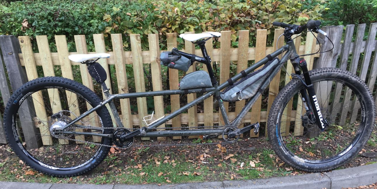

29 x 2.8 on the back with a Bulldozer up front on our long niche tandem, plus sized and hub geared. Rolls really well and grip is way better than what we have had for years preceding this.
